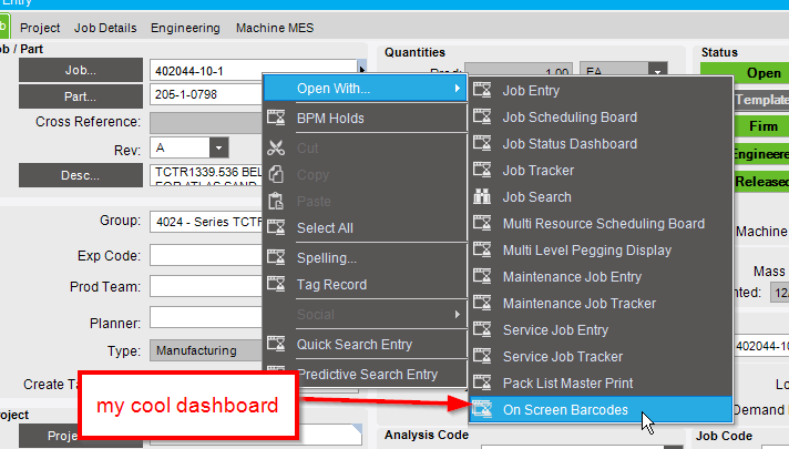

  2. Having a dashboard launch from the “Open with …” context menu
The dashboard is similar to the Part Transaction History tracker, and is based on the user supplied partnum (either by typing it into the tracker filed, or passed via the “Open With…”.

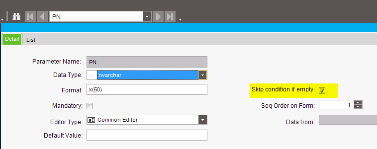

The dashboard still prompts me for the parameter I defined, when I want it to use the value from the tracker pane in the dashboard. Setting the BAQ param to ‘Skip condition when empty’ allows me to ignore the pop-up for the param value (I leave the value blank and just hit cancel), and the results are as desired.

Secondly, whats the best way to make a dashboard launchable from the “Open with…” AND have it preload the connected value (PartNum in my case)?

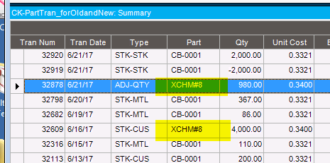

My BAQ has an unusual join, and the PartNum column in the query result, can contain values different than the input Param.
Using the Tracker as the input, limits the dashboard to display only that value.
For example: PartNum XCHM#8 was replaced by CB-0001. Entering ‘CB-0001’ in the BAQ param, will return PartTran records for PartNum = CB-0001 OR XCHM#8
Leaving the BAQ param blank, but entering CB-0001 in the tracker pane yields no XCHM#8 records.
Notice that the recs for XCHM#8 are missing (should be inserted where the arrows are)
In your BAQ can you make another column with the originating part, then filter by that column instead of your display one? You don’t have to show it to filter by it.

this works now. You can just hit ESC when the Param prompt pops up - because I set it to “Skip Condition…”

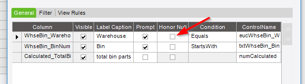

You could just remove the parameter altogether then, and make the tracker value filter on null. (edit: I guess it’s called “honor null”) Then it won’t return anything if they don’t have anything in the tracker.

Param in BAQ:
Param in use (2 places)
Dashboard with Tracker Prompt field entered (before hitting refresh)
Hit Refresh, leave param field blank, and click Cancel:

right. Try this once. Remove the parameter criterias, then in your dashboard check the box below in the tracker criteria.
Tell me if that works the way you want it to.

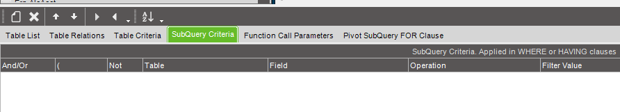

But what I do have is two sub queries that each contain a single table. See the picts in post 9.
these two subQ’s are unioned together. I added a filed that will always contain the criteria value to each of these subs.
The top level SubQ is joined to the union of the other two, and that column that always shows the param value is include in the fileds displayed on the top level. The Dashboard filters on this column (the one that always shows the param value)

Looks like that works.
But now my BAQ runs REALLY full out. Is that bad?
Your dashboard tracker will throttle it. That’s why you want to set the part number filter in the tracker to honor null. Then they can’t run it wide open.
it was doing that when you skipped the condition in the parameter already.

Do you know how to launch a dashboard from a “Open with…” right click, and pre-populate a tracker field on the dashboard with the linked context?
  1. Right click on a PartNum filed in a standard form, see “Open With -> My cool dashboard”
  2. Selecting “My Cool Dashboard”, launches that dashboard
  3. My Cool Dashboard appears with the PartNum tracker field already populated with part number that I right clicked on in step 1.
Having it automatically refresh would be sweet, But I’m okay with having to manually refresh.
