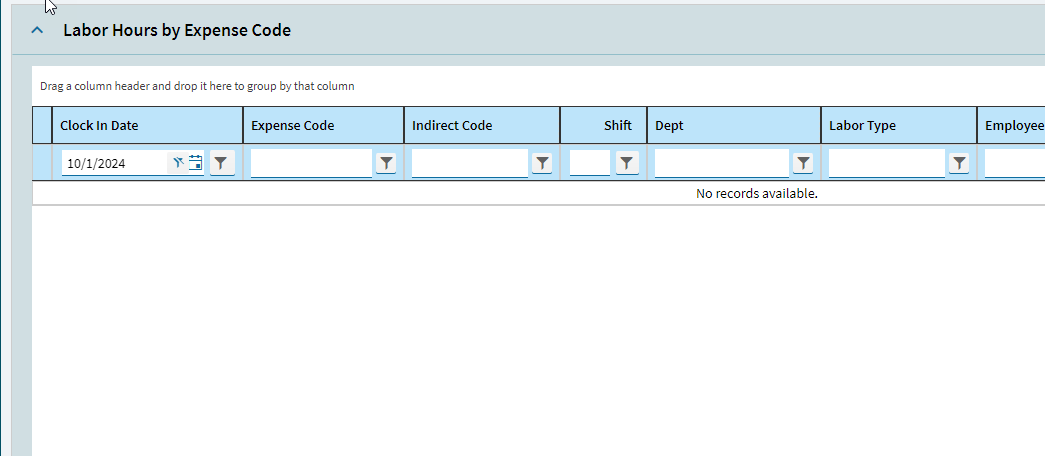

Here’s an example from one of our resident wizards:
