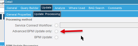

but to do that, the BAQ would need to be updatable right? Even if it doesnt need to be?
Correct. Just check the box that says updateable, Then use “Advanced BPM Update Only” so it doesn’t yell at you.
Then in your dashboard, you don’t need to turn on any of the updateable stuff. But the drop down will still work.
that worked. not 100% as we need but close enough :slight_smile:
