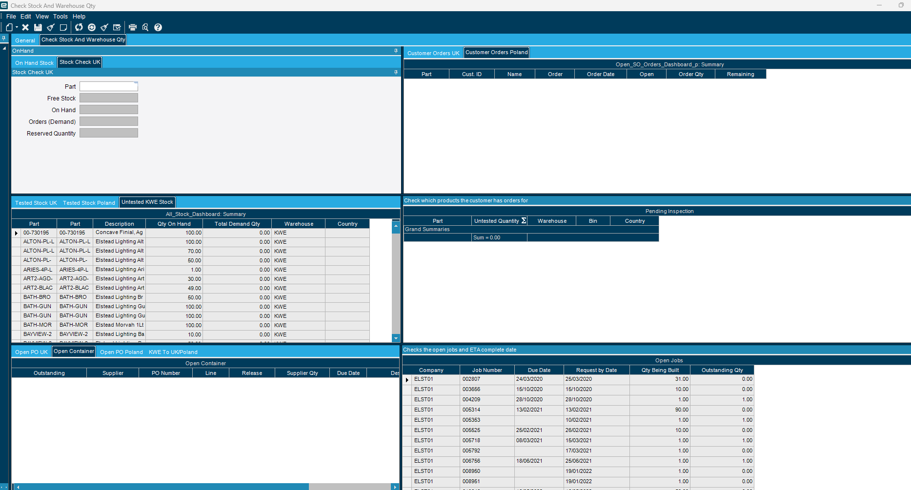

Hello, we are currently testing kinetic ready for our upgrade in february the biggest change we have noticed is part tracker, currently for part tracker we made a dashboard made up of multiple baq’s which made it easier for the team to undertstand current stock and incoming stock etc which looks like the below

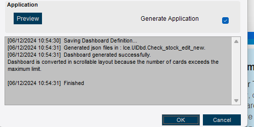

I tried deploying it as an application on kinetic but got the below prompt

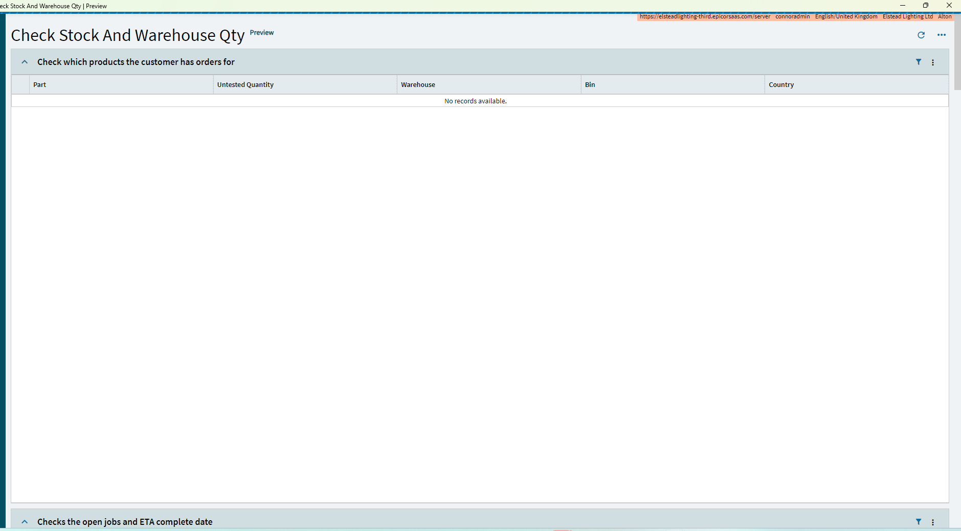

Now when I load it in application studio it looks strange

You have to modify it to get closer to the classic version but its not going to be 100% the same. I recommend using this guide
What version are you working in for Application Studio? If it’s 10.2.700, just give up. No, really.
App Studio is not very usable till at least 2022.2. What version are you going to?
