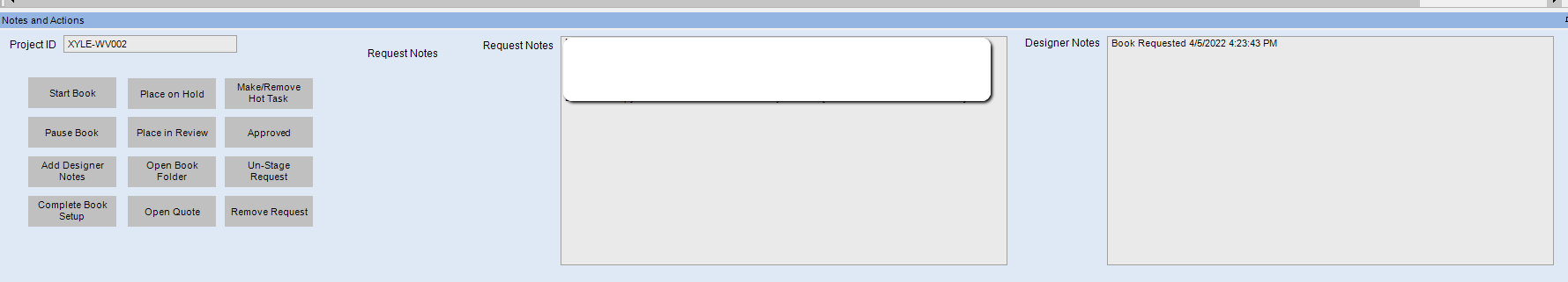

Good morning Mega-Minds! I’ve run into an issue with an existing dashboard that I’m trying to change. The department this is for wanted smaller buttons and text fields resized and moved. It’s pretty basic stuff really. But Epicor has decided to make it not so easy. I have a customization called Parts that is set in the menu…
I made the requested changes to this customization on the dashboard. The buttons are smaller and the text fields have been resized and moved. When I load the dashboard in Developer Mode, it looks correct…

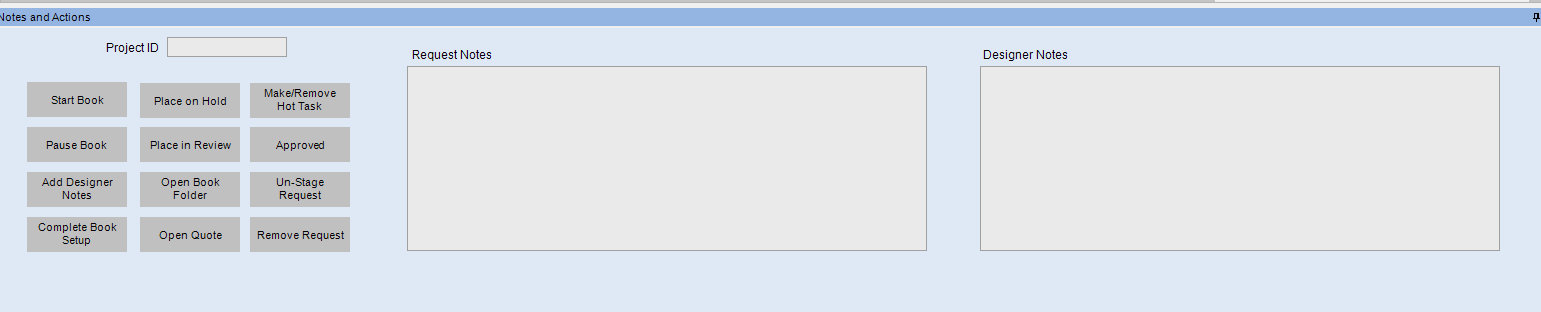

But, when I restart Epicor and clear the Client Cache, then load the dashboard in normal mode, the buttons are right, but the text fields go back to where they were…

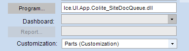

  1. I find it odd the dashboard field isn’t populated. This is an assembled dashboard correct?

  1. Yes, it is an assembled dashboard. The lack of data in the first image was because I had just closed out the developer window. The second image shows the dashboard in normal mode.
