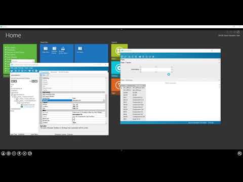

Dashboard Filter As You Type - Example Video
I was recently asked about a really old Youtube video I did showing a filter as you type in a dashboard. Looking back at my video I realized I did it a much harder way then I needed to. I made a new video showing how to add filter as you type in a customized dashboard.
Very cool!
Here is a code if people would like to copy paste.

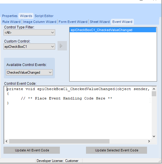

Do you know how I can filter from a check box? I don’t think I can build that into string.
Calculated field is ā€œtrueā€ or ā€œfalseā€ based on case.
CASE
WHEN Part.PartDescription LIKE ā€˜%2P%’
THEN ā€˜true’
ELSE ā€˜false’
END
I’m not sure how to write a variation of the code to filter by an ā€œon clickā€ check box.
string filter = String.Format(ā€œCalculated_TwoPole = trueā€,epiCheckBoxC1.Text);
Here is my crappy solution. When box is checked, filter the calculated field by string.
Had to change my calculated field to string.

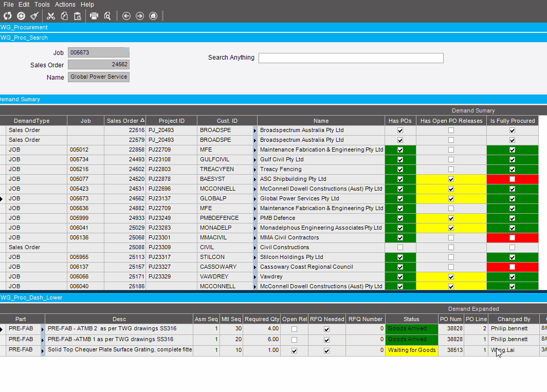

Code works perfect for filtering. But one issue apears, if I use row rules to color cels by values and try to use filter as you type issue apears when you clean the text box, row rules clears out and color disapears. Any ideas how to keep them working in paralel together?
Before filtering:
After cleaning filter:

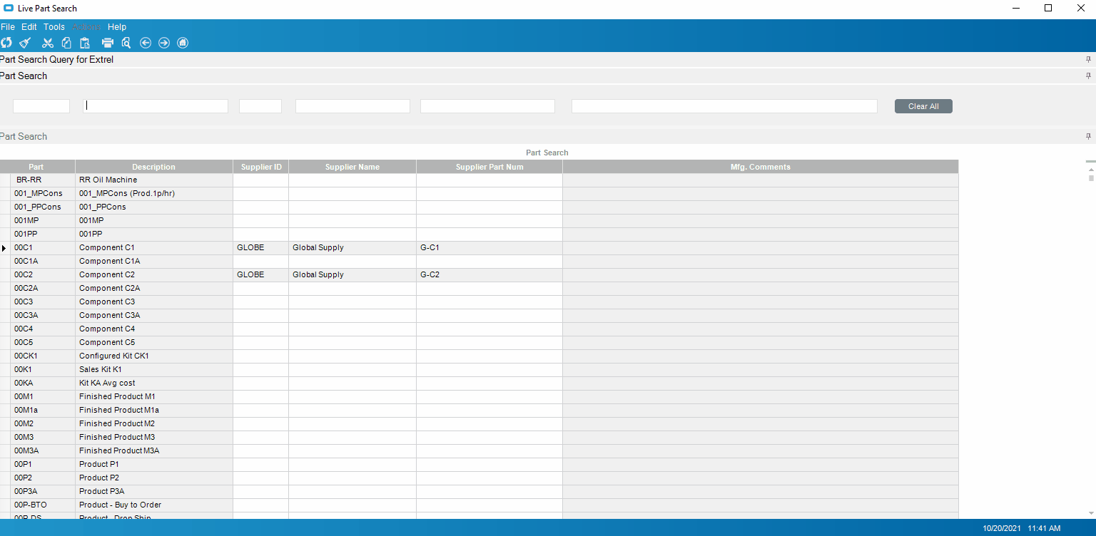

I followed the instructions and examples above to get multiple filters working (filtering both multiple fields on a grid and multiple criteria on each field, each separated by a space), and figured I’d share the code in case anyone else finds it useful.
Here’s the result:
LivePartSearch
I moved most of the code out into a couple of functions, that can just be copy/pasted with minimal updates to field names all in one place. (Having just the few lines to update all in one place certainly helps when you change something on the dashboard and re-deploy, which requires completely redoing the customization.)

Then you just need to update that series of lines that build up the filter one field at a time, e.g. filter = add_to_filter(filter, epiTextBoxC1.Text, "Part_PartNum"); with the names of the controls and columns that you want to filter on.
And call update_grid_filter() any time the value of the fields changes. (I also added in a ā€˜Clear All’ button that wipes out all of the search field contents, as a minor convenience.)
