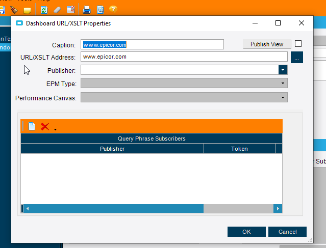

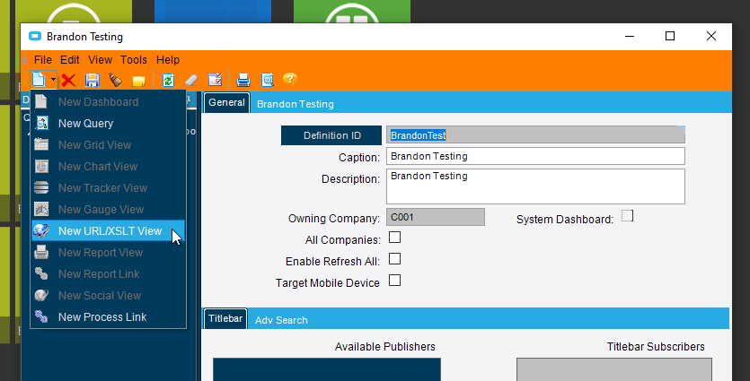

Try this. The URL viewer will show web pages, but it can also show other file types. I’ve used it before to show PDF’s from a network file system. It should use whatever viewer your computer has set to see the type of file you end up with. You can build the address using tokens which can pull pieces, (or all of it) from your BAQ, so it will publish/subscribe to the row you have selected in the BAQ

If that is the case, I suggest this solution (in this, there will be an image holder and as you click on different rows, image changes):
If you want to show them in the table itself, then maybe this is what you are looking for:
