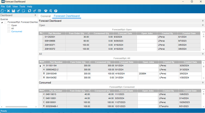

Building a dashboard with multiple girds. They have simple filters. In the dashboard builder everything works great. After deploying, the ones with filters show no data. Tried redeploying several times. I have other dashboards just like this no issue. What is the trick I am missing here?

Sadly no. Some of our dashboards only populate when you sort columns, but that didn’t work either.
I don’t know if you are missing a trick or its just a bug. I have ran into the same behavior in kinetic and just do not have time to fuss with it. What I have found is that building the dashboard in classic and then deploying the app from classic “Dashboard” results in a kinetic dashboard that does actually refresh.
