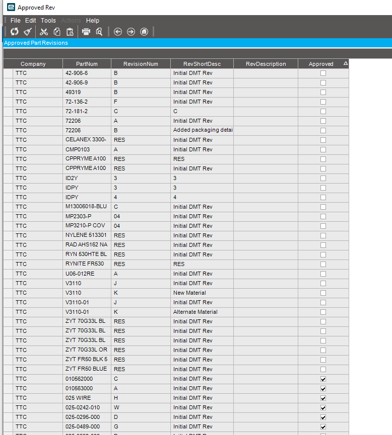

Thank you that worked. Quick question also. I am not sure why i am getting approved and unapproved parts. I thought it was because the part revision that is unapproved was still in inventory. but these are not.
Tanya
That’s not possible for anyone here to know without seeing what your query is doing. My guess, from the data that you are returning, is that your query has nothing to do with the inventory tables.
