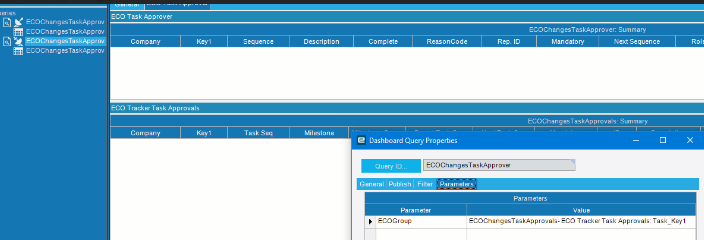

Have you tried publishing from the first to run BAQ, then subscribing the parameter to the published field? Go into the dashboard query’s properties and go to the parameters tab and subscribe.
