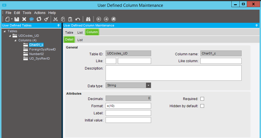

- Add some UD Fields to UDCodes table. These will be used to hold the values that your BAQ will use instead of parameters. i.e.

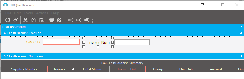

Now , what we need is to auto-create the UDCode record (before the BAQ is executed) that will store our “Parameter” values. Create a Dashboard Assembly menu item for the Dashboard and enter customization mode.
Add any Controls (not need to be bound somewhere) that will hold the “Parameter” values , in my case the InvoiceNum, you can hide the CodeID textbox and label.
- Add the following code to Create the UDCode Record before the BAQ is executed, also remove the UDcode record just after the Execution.
