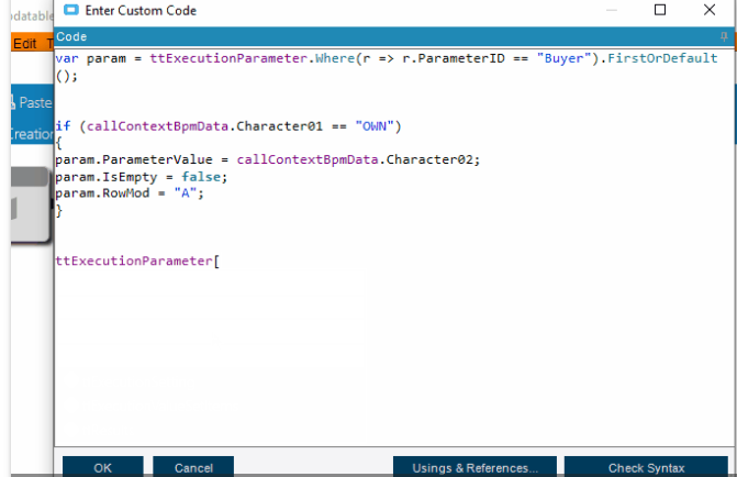

Have you found a solution for this? I tried to use your code in the Pre Processing in GetList in the Updateable BAQ but ttExecutionParameter is not defined and I’m not sure how I can add values from there
That’s good to know that it wasn’t working because my BAQs are updateable, I was going crazy trying to find what I did differently than the last time I used the functionnality !
I tried this but for some reason, the parameter is not set to value I set:
