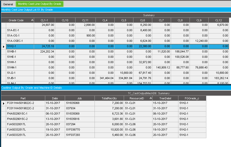

I have a dashboard with 2 queries in it. First query is to show the summary while the second query is to show the details of the selected line in the summary query.

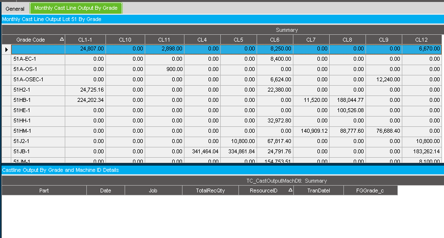

Unfortunately, the publish field from 1 of the lines in summary query is either empty or null has caused the second query to fetch incorrect data.
By checking at the SQL Server Management Studio, the query does return result if the publish field is ‘’ (empty), but does not return any result if the publish field is null.
Please advise what should I do in order to show the details in the dashboard for field which is empty or null.

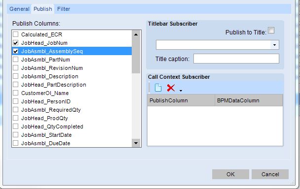

Just to make sure you are looking at the properties of the dashboard query, not the dashboard grid properties.
Your first dashboard query you publish like the following.
Capture
The second dashboard query you filter on the fields.

Just that my first dashboard is publishing an UD field which is null-able.
When the published field is Null, the second query won’t show anything.
