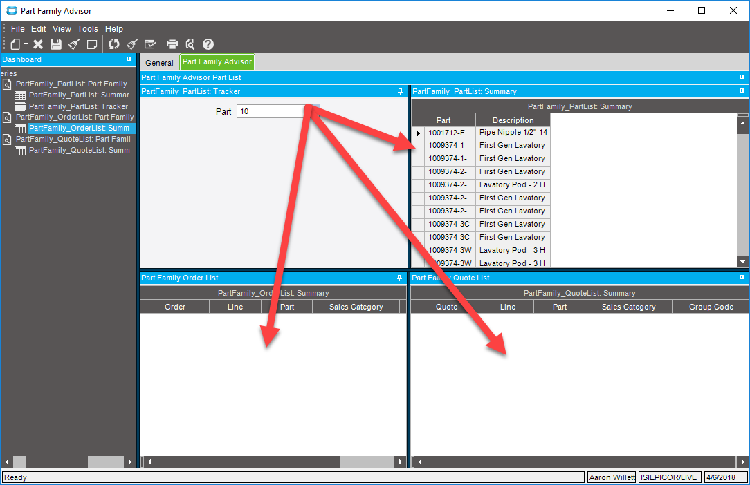

Is there a way to share the tracker criteria between multiple queries in a dashboard?
I don’t want to use the publish/subscribe because I don’t want to filter the other query windows on the exact part number. I want to filter on “starts with” which is what the initial tracker view filters for.
If anyone is interested, I accomplished this by adding tracker views to each grid, deploying the dashboard as an assembly, and writing some script that populated the other 2 tracker views based on the input of the first one.
