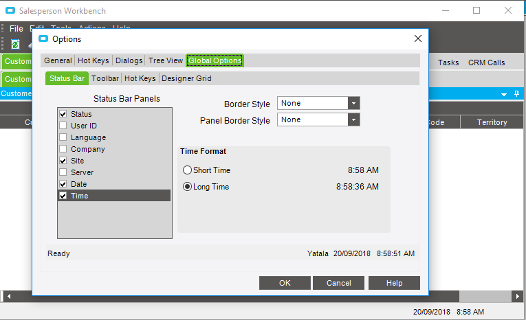

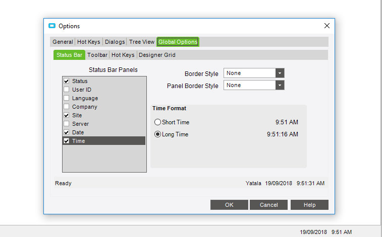

Multi Site company want to display the Site in the status bar of my newly created dashboard.
The Global options for status bar has Status, Site, Date, Time all ticked. After pressing Ok, the status bar still only show Date and time only, see picture.

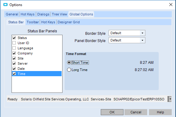

Here are the options I have selected and I get my company each time.

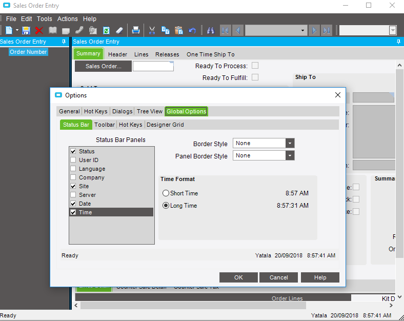

For screen like Order Entry, the Global Options work. I can see the Site ID
But for dashboard, such as Sales Person workbench, only date and time appear in the status bar.
