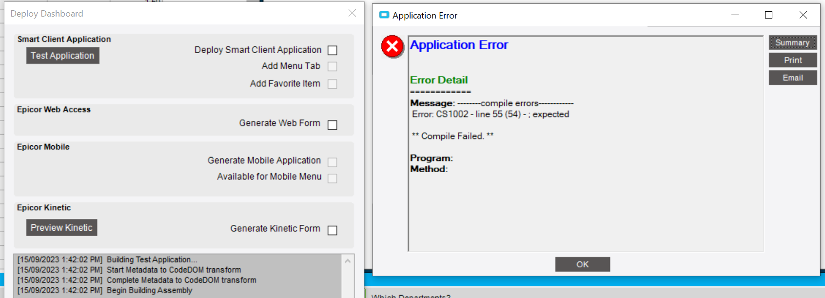

I have created a dashboard that that have a few BAQ’s that publish and filters. The data showed in the dashboard grid views are displayed correctly as intended. But before deploying, when I Test the application, I get this error:
No errors in the individual BAQ’s as well.
Does anybody know where I can start to resolve this Issue?
Thanks!

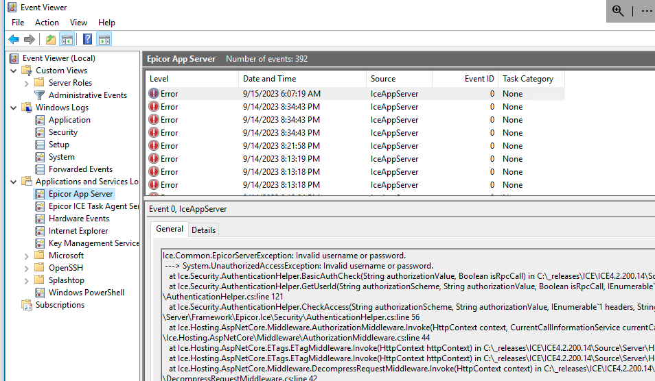

I’m not great at this myself but I’ll offer some help. I think, starting in E10, most of the error information is kept on the server for security reasons. You can start by going onto the server where Epicor is (I’m assuming you’re on premises) and opening the Event Viewer. Drill down into App and services logs click the Epicor App Server. You should be able to find the error and a more detailed description of what failed there. HTH.
