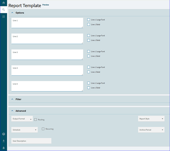

I’ve been asked if we can create a simple dashboard, where the user can enter 4 or 5 lines of text (manual entry… not mapped to any specific table/column), and then send it to a label printer.

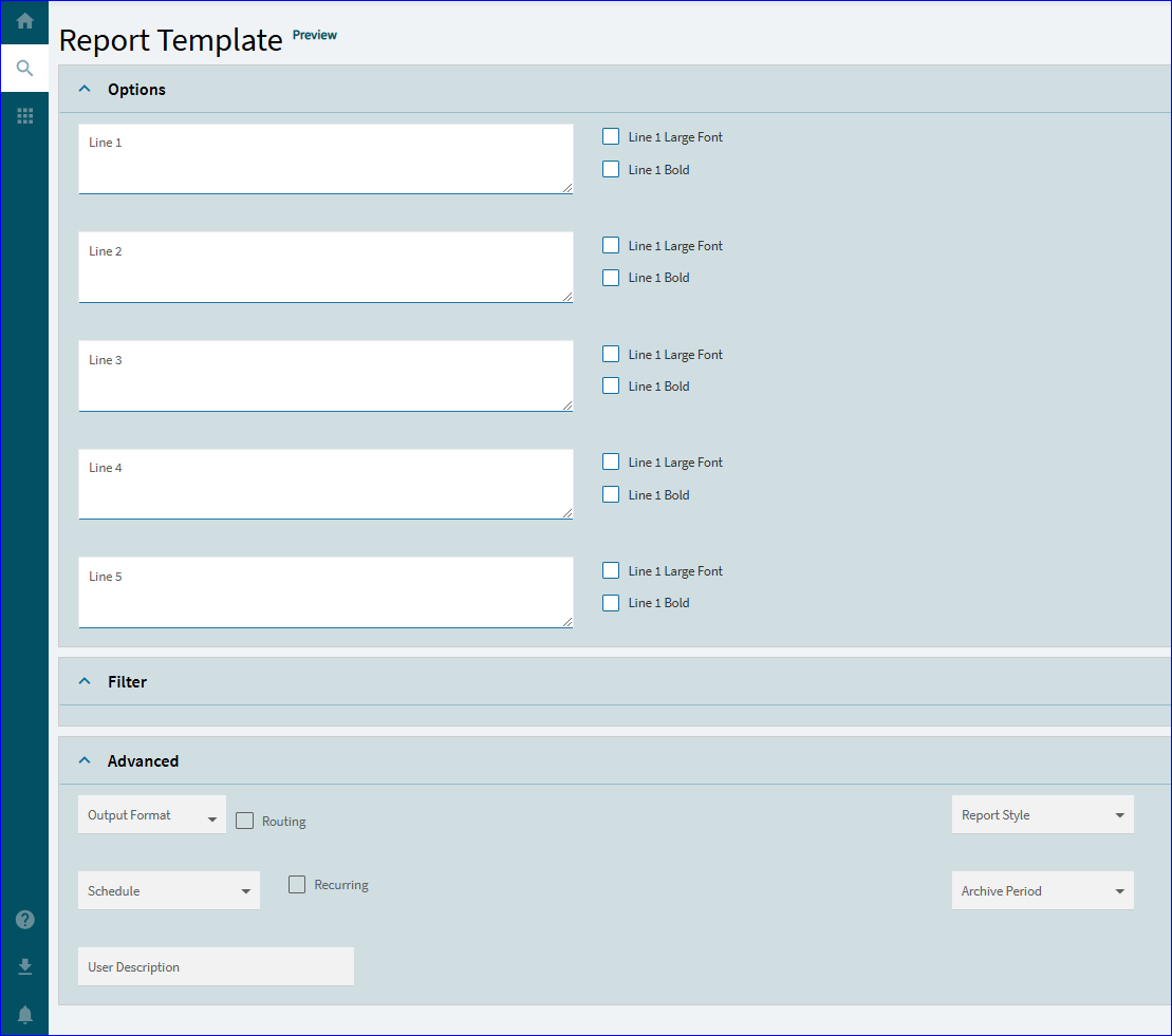

My thought was just to create a simple dashboard, or Print menu that includes text fields, perhaps some options for large font and/or bold… and then that gets pushed out to an SSRS report. Mock-up below:
I’m thinking I can potentially bind these controls to CallContextBPMData columns to store values and send them to the report server (if that works, I know it was busted for the Browser awhile back).
But I’m not sure what is required to get this off the ground. Do I need to create an empty BAQ report, maybe just query the Company table or something, so I can basically have a more-or-less empty dataset? Again, I’m not sending any db data… just the values they manually type into the form.
Any thoughts, ideas?

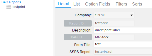

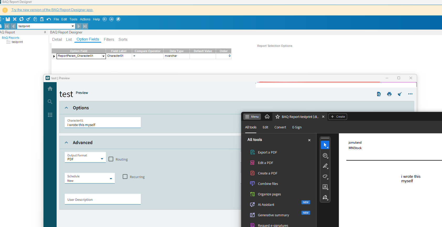

I tested this quick with a BAQ report adding an option field linked to nothing. Seemed to work? You could do all your formatting and stuff based on inputs.

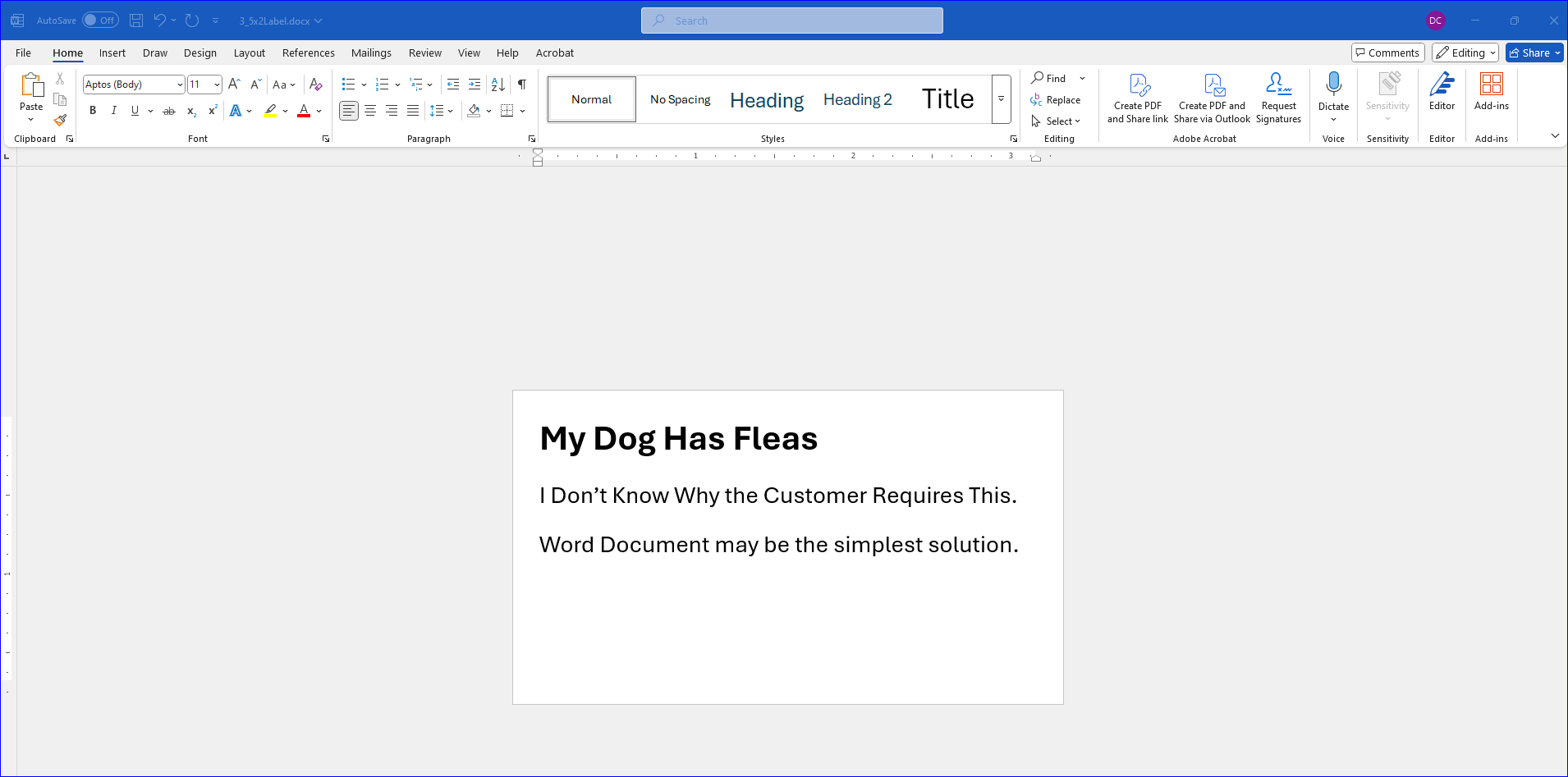

Okay, shipping was more than happy with a simple Word document… so… request resolved, doesn’t need to be IN Epicor.
However, @jsmuland, since this was my original thought… did you need to actually create a BAQ so there was something to send to the report server? Or did you just create a BAQ report and only include the option fields?
That’s what I was trying to figure out…
The “KISS” method wins the day.
I selected a random BAQ that doesn’t take long to run and didn’t bother using any of the data in the report.
Struggling with the character limit(I got 104) so probably not the best anyway for longer labels.
