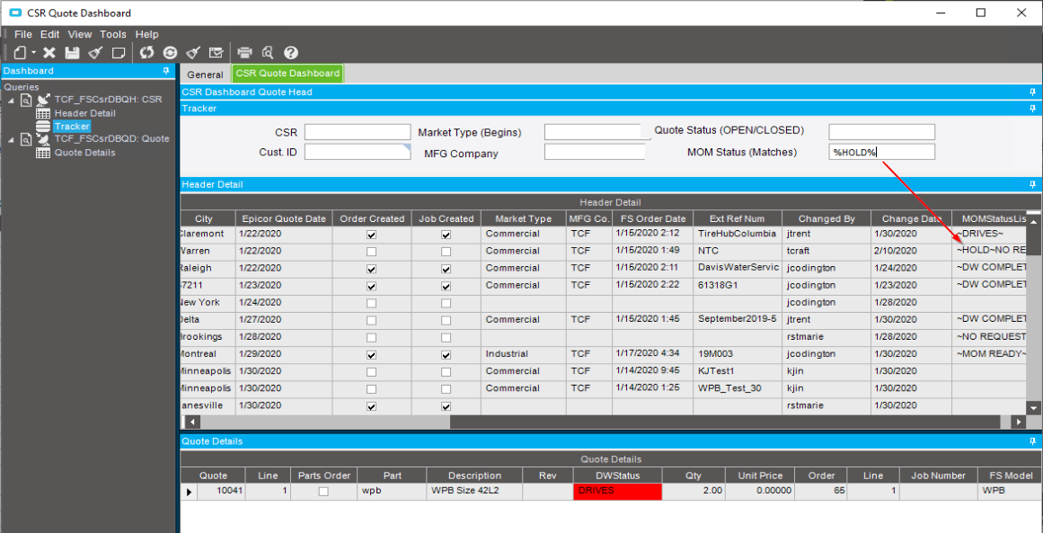

On the quote dashboard I have a header-level calculated field with a tilde-delimited list of quote line statuses. The filter is set up as “matches.” The problem is that it’s not matching, even if I use wild cards.
In the following image I’ve entered the filter value "%HOLD%, but have not yet hit refresh:
After the refresh:
I’ve tried asterisks as well.

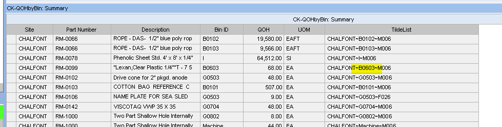

Hmmm … seems to work with either * or % for me.
Here’s the unfiltered data:

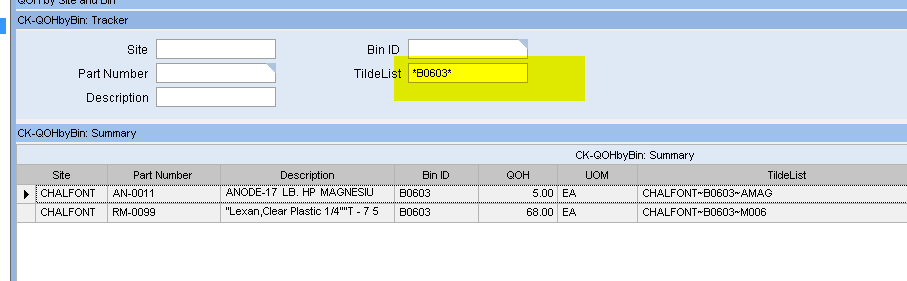

Here’s the filter I added in the Tracker
And here’s the results using *B0603*
You are hitting “refresh”, and not just tabbing out of the field?
