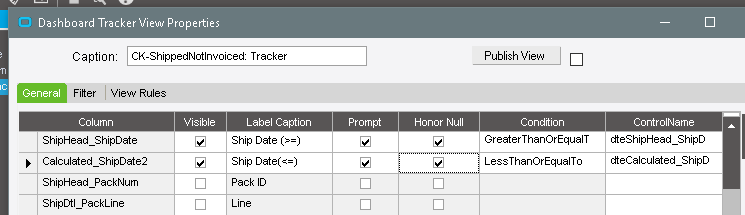

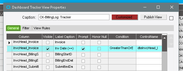

Check the properties of the Tracker. The General tab shows all the fields that are visible, and if theye are a Prompt (used as input for filtering). If it is a Prompt type, there will be values in the Condition and ControlName columns.
An example dashboard of mine that filters on the InvcHead_InvoiceDate field.
Any of those in use?
And FWIW - to allow a range for filtering, I would have added a calculated filed to duplicate the value of the field I’m filtering on. Then show this second field on the tracker, but set its condition to LessThanOrEqual.

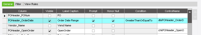

I did find a dashboard where I did what you’re trying to do - one built-in and one custom control for a range. Both are for the same BAQ column, POHeader_OrderDate
The Tracker one has a condioton of >=
And the custom control is set like:

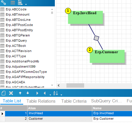

My only advice might be, how is the query structured? Is InvcHead the first table?
I sure am curious about this one.
No, it’s like this…
from Erp.InvcDtl as InvcDtl
inner join Erp.InvcHead as InvcHead on
