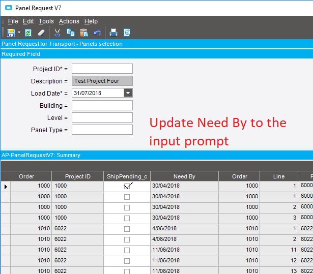

I have a Dashboard with one Update-able query (UBAQ).
I created a TrackerView to allow user to filter the data. So the user type in the information about the Load Date.
What I want is when the user tick a tick box in the Update-able BAQ, the Need By date which is a column field in the returned row be changed to the Date the was input in the Tracker View. I can do a BPM and run custom code when the user tick the box. But I cannot get the Date field that is in the Tracker View.

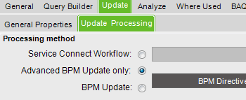

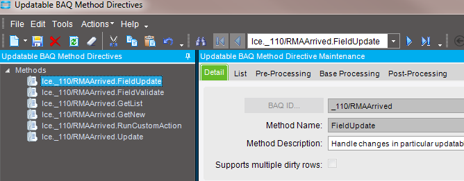

If BPM:
In the Updatable BAQ > … Advanced BPM Directive Configurations, FieldUpdate change event method directives , you can write code to invoke Sales order BO and call ChangeNeedbyDate method.
