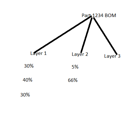

Hello,
need you guys opinions. in the kinetic cloud, can i create dashboard look like as below
thanks,
Eddy

Eddy they say a picture is worth a thousand words, but I think I’ll take the words this time… Can you explain further?
Funny, but I actually know what this is.
It’s a 3 layer extrusion blend for plastic film.

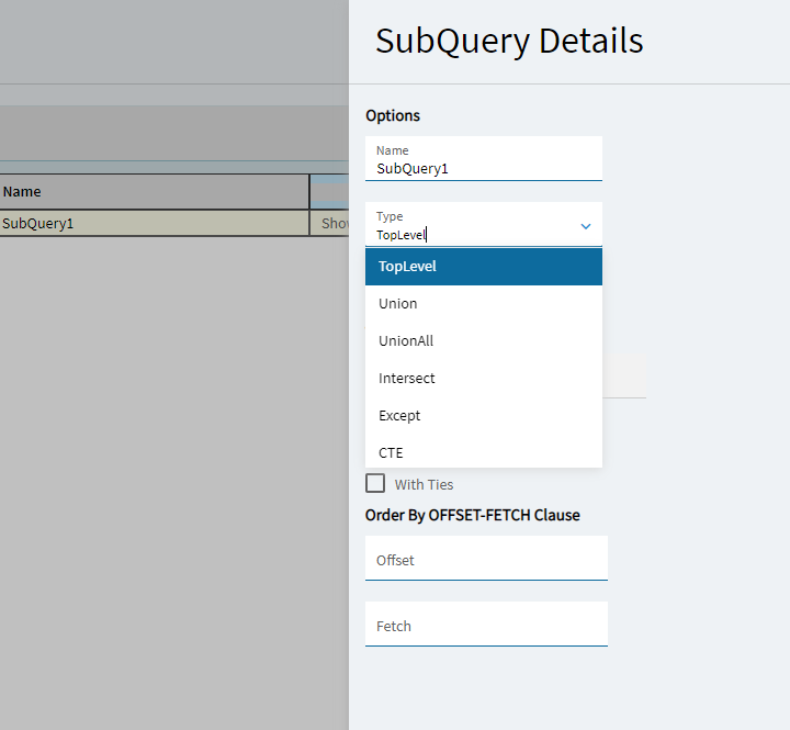

Hello,
in the BAQ, I did not see the PIVOT.
Don’t know how to PIVOT a table in the BAQ then.
Regards,
Eddy
The Kinetic BAQ designer is in “Preview”, and is not ready for real work.
Use the classic designer.
I haven’t looked lately, but if it’s in the Kinetic one, it’ll be with the phrase builder section I would guess.
Hello,
still don’t know how to pivot the table in baq. there is no such option. also, we have to use kinetic.
regards,
Eddy
Probably out of luck then.

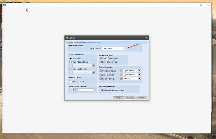

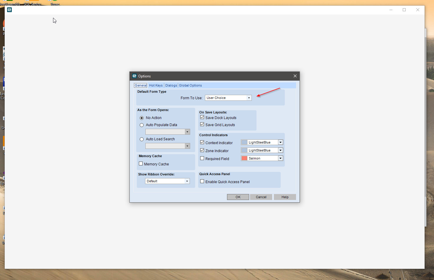

Are you running it from the browser or the smart client?
From the browser it won’t work obviously from the smart client you can hold down
Ctrl + Alt and select Classic from here
From smart client.
