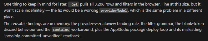

I used EpiDev & Claude to look at our broken dashboard in 2026.100 (that works fine in 2025.2). Something is wrong with ProviderModel still. We’re on 2026.100.9 but not sure our PILOT has the hotfix that’s been mentioned. Claude ended up rebuilding it to not use Provider Model at all but it returns all rows then filters at client side. :grimacing:
