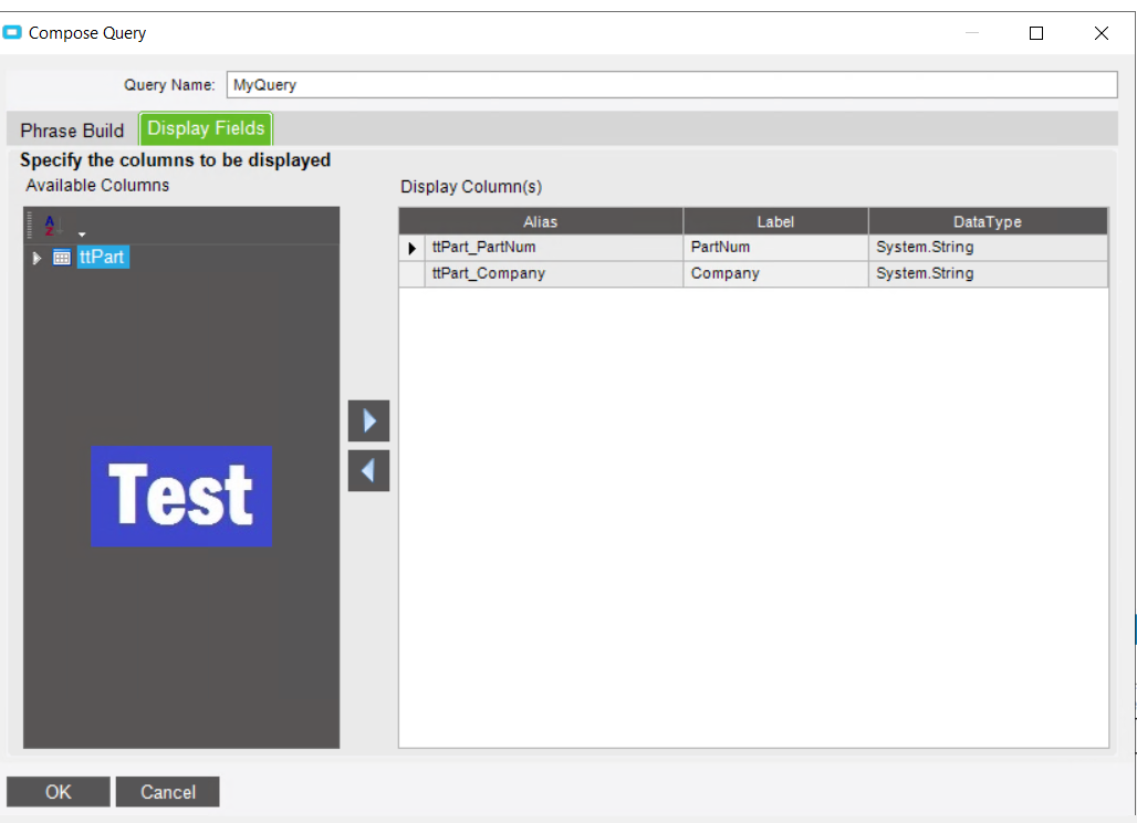

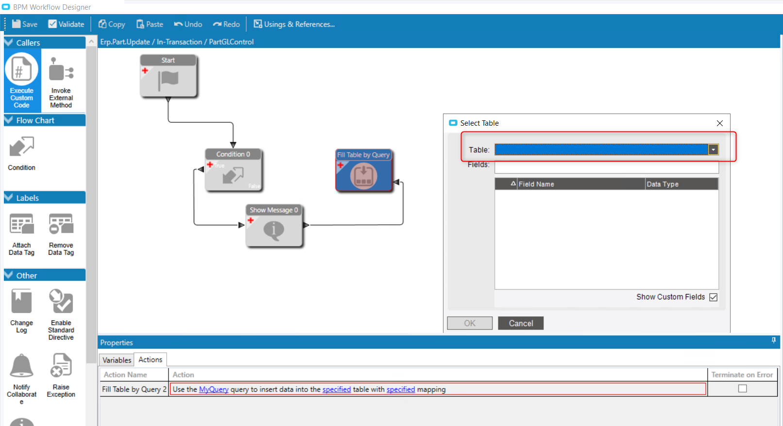

I am creating an In Transaction Data Directive BPM which I would like to use “Fill by Table” but when I open the “Specified” table there are NO Tables to select.
Did you define your query?
Hmmm, that’s an odd one. Any chance there is security that is stopping you?
No, I don’t think so I created a Method Directive using the same workflow and I am able to access the table list
I would open a ticket with support or search their KB. Unless someone else has seen this before and jumps in.
I don’t think there is a table in there you can fill.
This is an in-trans directive, it works on rows, one row at a time.
I just realized that right before your email came in!
