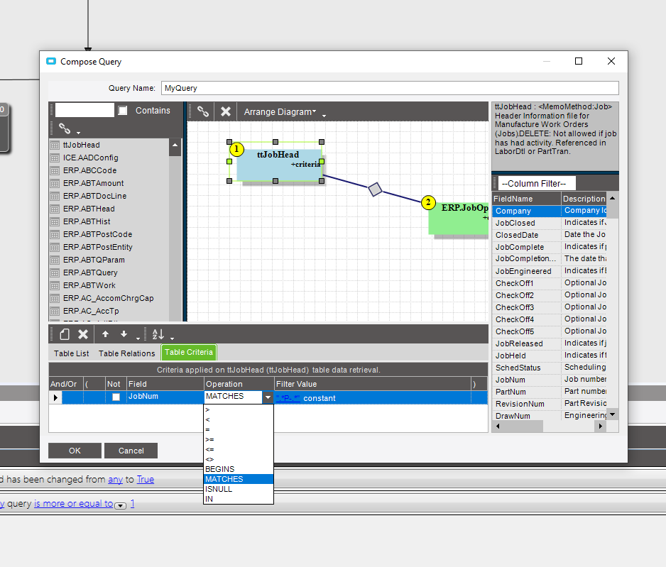

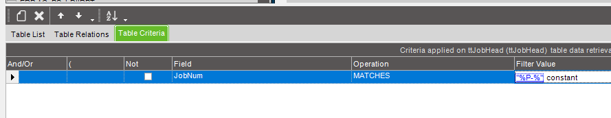

I had a Data Directive In-Transaction firing on JobRelease going true and a JobNum MATCHES “%P-%” in 10.1.400 working smoothly (JobNum looks like this 21-11812P-01 ,21-11812P-02 or could be an F or H in the place of the P which I would want to ignore.
When we upgraded to 10.2.500 it will not fire anymore with the MATCHES “%P-%”. Is there a new way to pick off a character in the middle of a field in the DD query editor?
I found a work around but would like to use this method again if I have the wrong syntax.

You could switch it to “CONTAINS” instead of “MATCHES” and then just remove the wildcard characters.
Looks like “MATCHES” uses RegEx on the back end now.
Try doing this:
".*P-.*"
With .* (period asterisk) being the wildcard.
Unfortunately there is no Contains in the BPM Workflow Designer, Compose Query editor
However your solution to substitute the (period asterisk) for the (percent symbol) for the wild card did work!
Thank you
Mike
MATACHES in BPM supports asterisk (*) and probably dot(.) and nothing more.
It is translated to C# code, not to SQL one. So % or _ cannot work.
