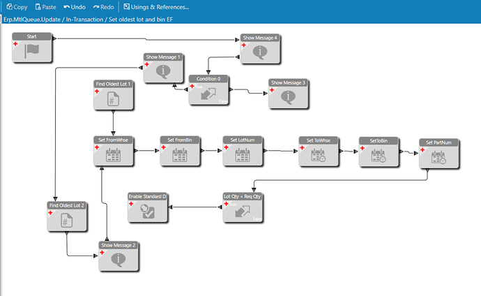

Here’s the In Tran portion of the BPM, which is setting that Oldest Lot logic onto the MtlQueue table:

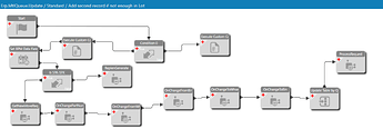

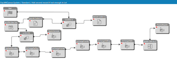

This is the Standard part of the BPM, which is branching based on the TranType value (STK-STK or RAU-STK) as we want both Move Inventory Requests and Replenishments to follow this path. The logic is then calling widgets to create the new MtlQueue records as we couldn’t get a direct creation of a MtlQueue record to work.

In Tran logic checks for an added record and the desired TranTypes (STK-STK or RAU-STK). If TRUE, it will run the Oldest Lot logic that is in the previously shared code block that looks in the Supply Warehouse and sorts by smallest Lot number then selects the Lot and Bin to assign to the MtlQueue record. If the Move Qty is less than the On Hand of the Lot in that bin, it only assigns the Lot and Bin. If the Move Qty is more than the On Hand of the lot in that bin, it will assign the Lot Qty and set a context field with the original amount. It then does a check on the Qty and if the original is more than the assigned, it sends it to a Standard BPM.
The Standard logic checks the TranType and then routes it to the correct BO.Method calls. RAU-STK goes to Replenishment.GenerateManual, STK-STK goes down the waterfall path on the MoveRequest BO methods.
In theory, the result from the Standard BPM should send the created record back through the In Tran logic. However, all of my testing seems to show that it is being bypassed for some reason. A new record is created with the correct Qty but the next oldest lot is not assigned.
