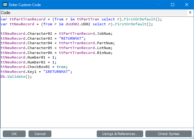

Below are the screenshots from my PartTran data directive showing the BO methods used for GetANewUD02 as well as the Update method, as well as some Custom Code that’s there to set a few values before sending it over to UD02.
I’ve confirmed that this code is getting hit and data is making it to the database, however the data directive on UD02 is never being activated. Is there something I’m missing here to get the second data directive to trigger? Thank you

First of all remove the Db.Validate() in your code.
You are using the business objects (correct way) therefore do not need the Db.Validate.
Try that first and see what happens.

I removed Db.validate() and the same thing still occurs (or doesn’t occur, in this case?)
