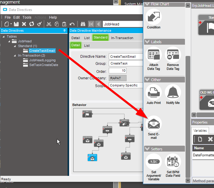

I have seen some topics here that you can actually send an email within a Data Directive. How do you do that? I see in my options under Other and the only ones I see are (change log, enable standard directive, raise exception and show message). The email option is not there.
I know that the email option is in Method Directive.
I am using 10.2.200
Thank you
Did you try creating a Standard directive (not In-Transaction)?
Standard directives are used more for notification type BPMs, while In-Transaction is for interacting with the data.
          What @Craig_Moore said. It’s only available in the standard directive.
          Awesome…
Thank you so much Craig and Brandon. That worked just perfect!
