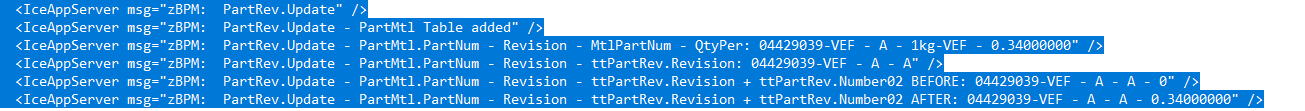

The lines below from the Server Log show that the code is running:
But when I run my BAQ to verify the field hasn’t updated:
Is it because I am updating a temp table \ ud field? I feel I must be missing something obvious but am running out of ideas of where to look.
