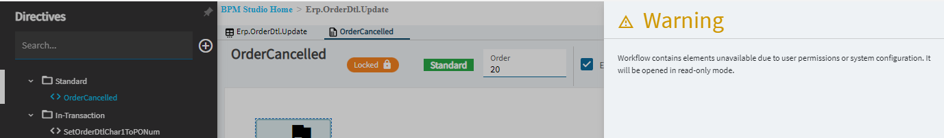

We recently upgraded to 2023.2. I went into modify a BPM and it did not save any of my changes. Okay fine, I’ll go into the Kinetic Data Directives. Gave myself the required access.
Data Directives for Kinetic
Method Directives for Kinetic
Now when I open my directive, I want to edit I get the following warning:
I went to support for help and their solution was to use classic :roll_eyes: Well I would if it would save.

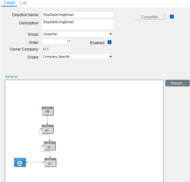

Is it disabled in classic - like for compatibility reasons?
It’s enabled.

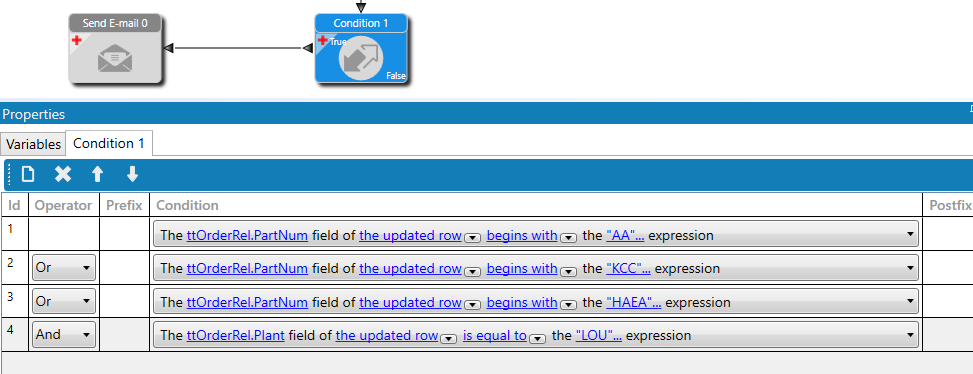

When I go into design make my change save:
then save in the data directive it disappears. Wait it saved that time :thinking: Let me see if i do the rest of the condition it will save all of it.
IT magic right there. :rofl:
Thanks! It works now. LOL don’t know why it does but I’ll take it.
