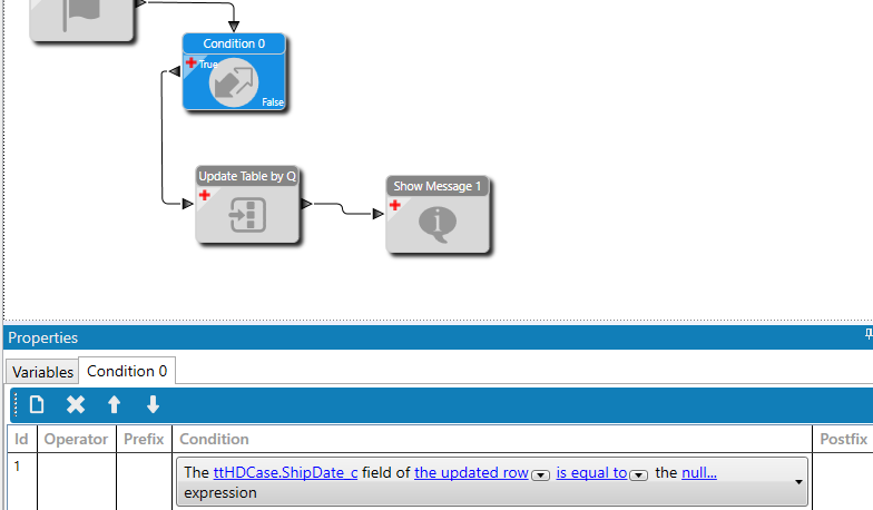

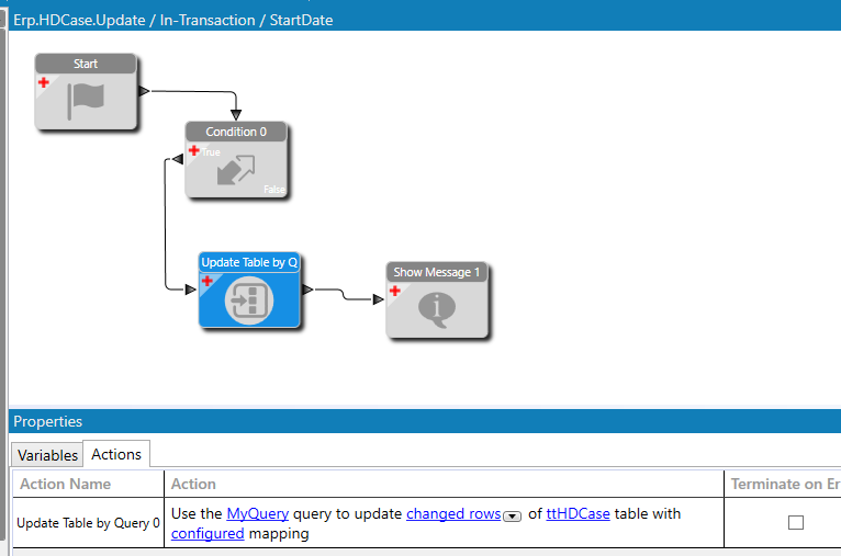

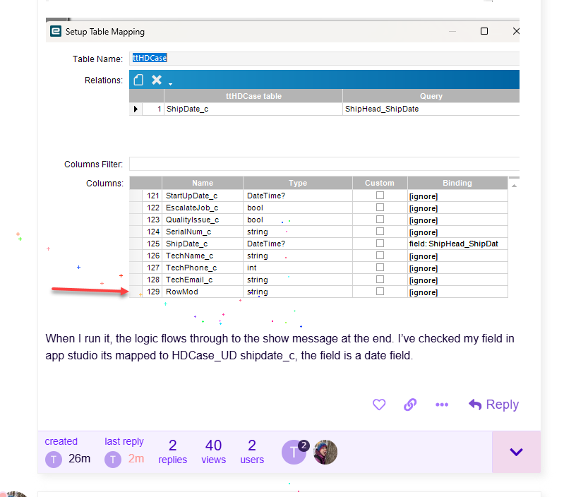

One of the suggestions was to move it to a data directive. I did that and it is flowing through the directive but its not updating the table like I want.
{45F470B0-DE83-4CE2-99EA-339B3E5D776D}

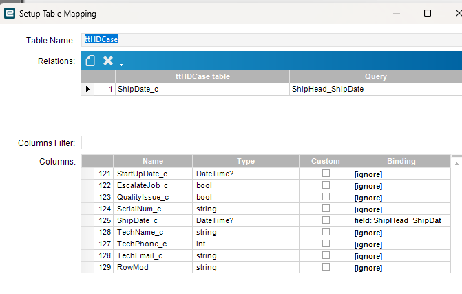

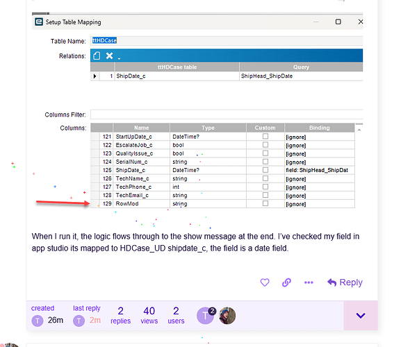

When I run it, the logic flows through to the show message at the end. I’ve checked my field in app studio its mapped to HDCase_UD shipdate_c, the field is a date field.

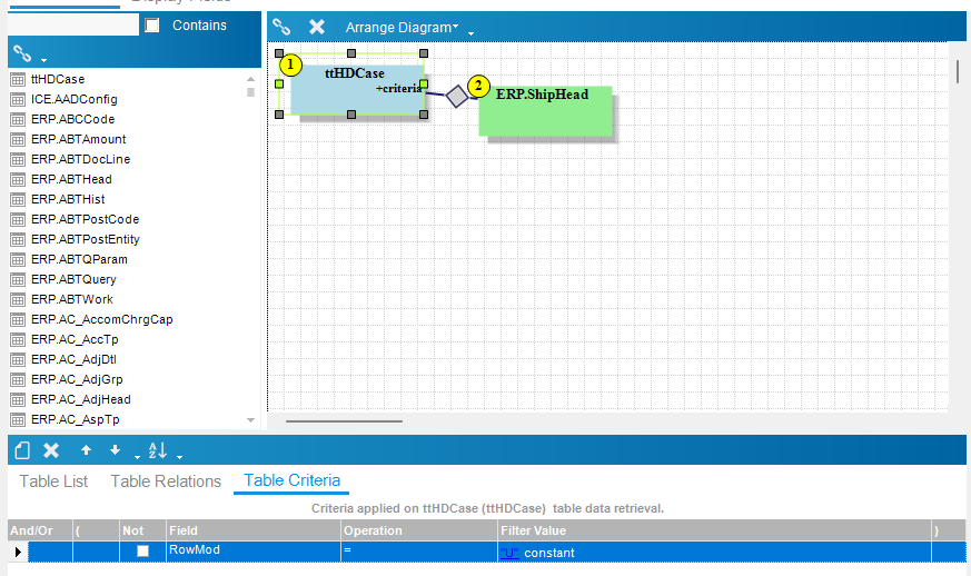

Set the RowMod field to “U”.
Do you set it here?
Thank you!
