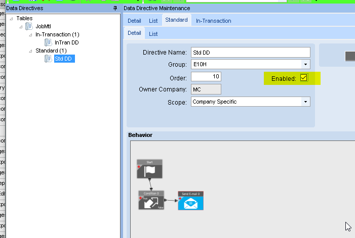

Give BPM Data a try. You can set the BPM Fields in both directive types, you will need to see if they pass through. Be sure to clear the data right after assigning it.
For in-trans directives, there’s a block called “enable standard directive”. You can use one of those in your in-trans directive, then make a standard directive for the e-mail portion. In the standard directive, use a conditional block and add the statement to catch when the standard directive has been enabled.

  2. Does the “Enable Standard Directive” widget just enable the referenced Std DD, or does it actually cause it to be called?
Does it actually affect the “enabled” checkbox on the Std DD?
If the Std DD’s Enabled checkbox was cleared, would the “Enable Std DD” widget in the InTran DD do anything?

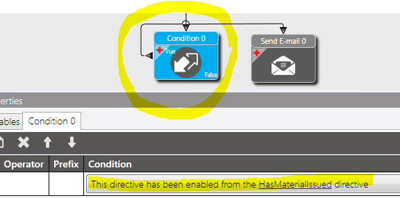

Point 2.
To call it in the standard directive you will need a Condition as the first widget that will say “The directive has been called from the SPECIFIED directive”. Where the specified directive is your InTran DD.

Then in the Std DD
  1. Condition block to see if it was called from the InTran DD
  2. Build your email, using the DD’s table for the new value and the callContextBpmData.Number01 as the prior value
