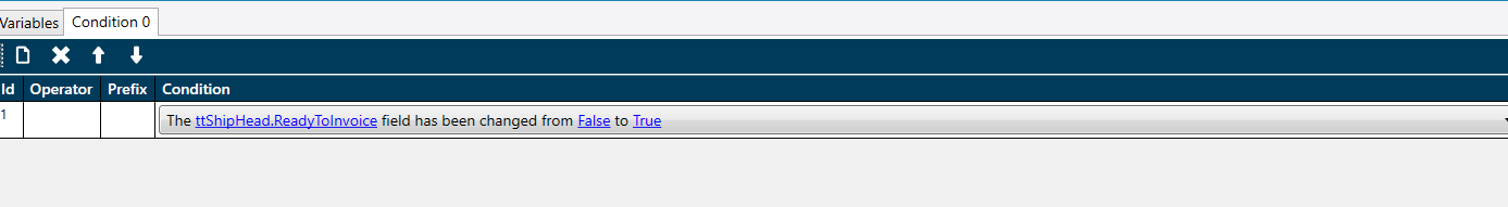

this is how its set it works fine on the pc but when they press ship on the scanners it does not print
Does the ShipHead.ReadyToInvoice flag get set when it is shipped by the scanner?

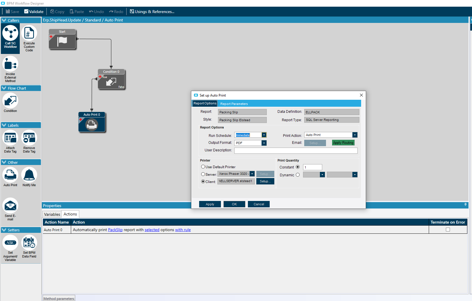

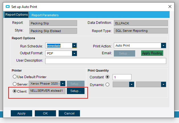

Also, it looks like the AutoPrint is set to use a client printer. The scanner probably doesn’t might not have access to the client specified.
yes if they mark it as shipped on the scanner it changes it to shipped on the pc its just the scanner version of customer shipment entry
