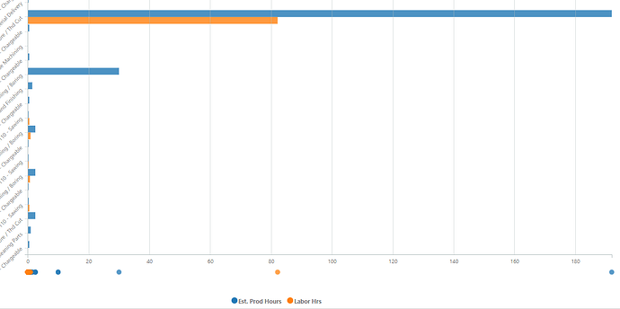

I’m trying to make a simple bar chart showing Job Operation Estimated Hrs vs Actual Hrs.
The problem I’m having is EDD always wants to SUM the Estimated Hrs.
In my case, I have an op with Estimated Hrs = 16
There have been (12) LaborDtl entries against that Operation… so the bar on my bar chart ends up with a value of 192 (16*12).
Is there any way to NOT have EDD want to sum values?
“Help” states that: “Measures are aggregate calculations such as Sum, Average, or Minimum used to roll up a numeric value.” But I haven’t found a way to switch between Sum & Average. If I could use average, I would get the correct value.

Appreciate the help. After some more trial & error this morning, I was able to get it to work. I had to convert “EstProdHours” to a string, and surprisingly, EDD allowed me to add it as a column in my chart.
Very finicky. I also had to make my LaborHrs a calculated field in my BAQ to populate a zero value in cases where there were no entries.
(case when (LaborDtl.LaborHrs) is null then 0 else LaborDtl.LaborHrs end)
