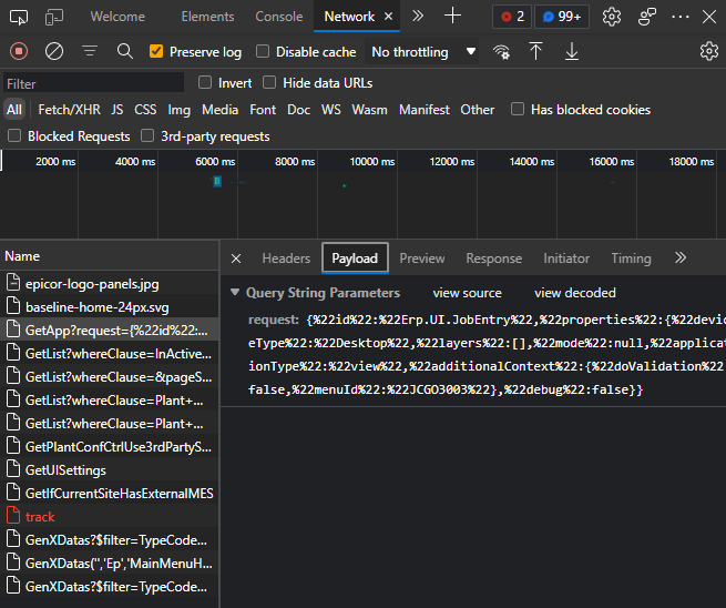

Where do I find this JSON? In the dev tools there are tons of menu options.
On the Network Tab, click on the line that says, “GetApp?request=…”
The Payload tab shows what’s going to the function:
    "id": "Erp.UI.JobEntry",
    "properties": {
        "deviceType": "Desktop",
        "layers": [],
        "mode": null,
        "applicationType": "view",
        "additionalContext": {
            "doValidation": false,
            "menuId": "JCGO3003"
        "debug": false
And the Response tab is where you pick up the JSON:
Don’t let the one line fool you, that’s about 50K+ lines when you format it in VS Code. Click on the text, Cntrl-A, and copy it. Then paste into your JSON-friendly editor of choice.
