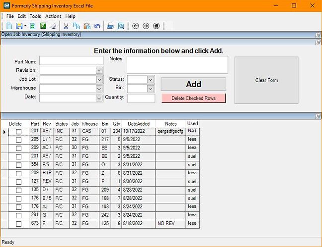

Data Entry Form in Kinetic
I have a great (classic) custom dashboard using UD09 to store temporary information about parts in stock for open jobs. The form is pretty simple with a handful of textboxes/combo boxes used as inputs, along with a grid view to show the table contents.
The classic form uses some code to help populated the drop-down boxes, as well as to validate the data before submitting it to the database with a BPM inside my BAQ. Here is the customization code:

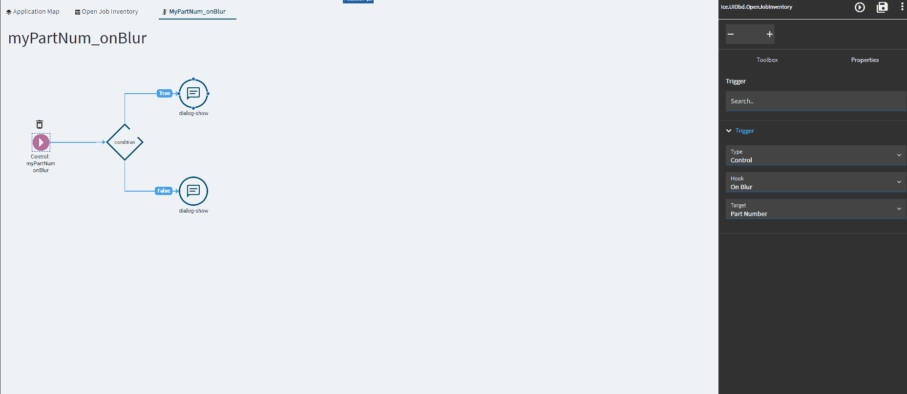

I have deployed this dashboard to kinetic and I am looking at it in Application Studio. I want to add all the same data entry fields I used in classic. I am not sure about how to add the customization code that allows the drop-down boxes to show relevant data. I also use that custom code to validate the field contents before populating the next field. For example, the function getJobs() looks at the part number and tries to find jobs for that part. If jobs are found, then the combo is populated with the list of jobs to choose from. If jobs are not found, an error message notifies the user to check the data. I am also not sure how to use my “Add” button to trigger my uBAQs BPM.
I also pass values to BPM call context. How do I do that from Application Studio?
I am guessing none of this is possible in Kinetic, but I may be a bit cynical.
I have added buttons to my form from Panel Grid Card > Advanced > Action Data. There I found the actions from my uBAQ.
Now I am implementing the data validation on each field. For example: on the Part number. I want the user to enter a part number, then have the revision combo box populate with the possible revs for that part. There is a BAQ to feed that combo, but I have to pass in some parameters. I am a bit lost on that, so I thought I woudl start east, and see if I can even get the condition to detect if my part number is blank. My condition statement keeps passing true, regardless of if my part number is blank or not. I put a couple of dialogs on the true and false sides of the condition. I have tried these syntax combinations in the condition’s parameter expression:
"{myPartNum<>Null}"
"{myPartNum<>''}"
"{myPartNum<>""}"
None of these ever returned false to show that there is a blank value. What syntax should I use to detect if my form field has a value? Then, what component do I pull in to the action to change the data source for the revision combo box, similar to what I do here (from classic):

I’m actually pretty sure most of this is possible; it’s a tall order, though.
Try {myPartNum} === undefined

Do you mean I should set my epiBinding for the part num text field to TransView.myPartNum?
Partially yes.
But you also need to get your myPartNum data from somewhere. Where ever/whenever you’re actually getting the value of myPartNum, create an event with a row-update to set that myPartNum value to TransView.PartNum.
The user supplies the part number. I want the user to type in a part number. If they forget to type in a number I want to catch that null value and warn the user they need to provide a value there. If it is not null I want to move to the next step of populating the revision combo box.
Okay, then yes. Bind the textbox to TransView.PartNum. Out of curiosity–what do you currently have it bound to when you were trying the compare earlier?
I tried setting up a temp data view. I called it TempUD09, and made its data source my uBAQ. Then I bound the textbox to TempUD09.Key1 (which is my part number field).
This seems to work. Kind of. When I first open the form the true/false dialgos show properly. After I have entered a value in the part number (and get the not null dialog) then I remove the value, I no longer get the false dialog box even when I leave the part number field while it is empty.
Change the trigger from OnBlur to DataTable > Column Changing/Changed.

Try adding some single quotes; I’m not confident that will change the behavior, but it’s worth a shot.
'{TransView.myPartNum}' !== 'undefined'
No more error! But it is still not quite giving me the right results. Is it this difficult for everyone?
KineticDebugging
When previewing use CTRL+ALT+8 to turn on debugging so you can see what comparison is happening when it’s checking the blank record. You may have to do something like:
'{TransView.myPartNum}' !== 'undefined' && '{TransView.myPartNum}' !== ''
