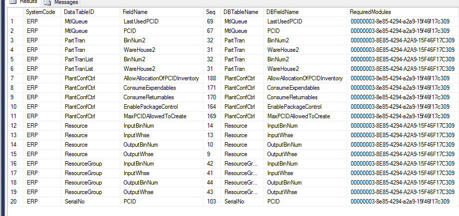

I poked around the table called ZDataTable [EDIT: ZDataField, sorry] (filtered to PartTran).
Yours are the only two fields stamped as requiring a module.
I’m guessing the module is multi-site?

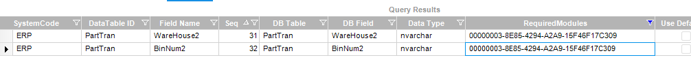

@ckrusen You are multi-site, right? So, what module is 00000003-8E85-4294-A2A9-15F46F17C309 ?
AMM?

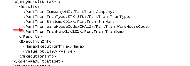

Also … Did a trace in the BAQ Designer (including “Write Response Data”), and it doesn’t conatin the columns for BinNum2 or WareHouse2:

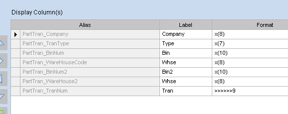

The BAQ’s columns are:
BinNum2 and WareHouse2 aren’t returned.
Well based on that exhaustive search, I’m going to guess that @jmarenghi, you don’t have AMM (Advanced Material Management) and that is why.
Unless someone has a way to decode that module GUID.
I queried the ZDataField table and only 20 fields in the entire DB require that Module

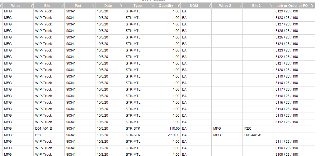

On the point about STK-MTL transactions, there won’t ever be a Whse2 or BinNum2 because it’s a transaction involving only 1 bin - no from and to, only a from,
