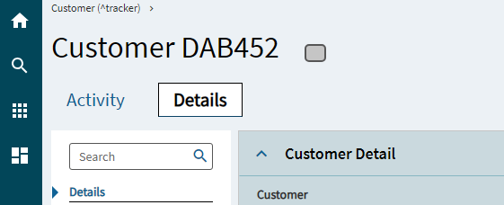

That worked a treat…except when Read Only is applied to the menu item, it marks everything as disabled, including the epi-shapes…unless…it’s a system shape! WTF?!?

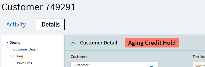

Regular Kinetic App with my epi-shape

Kinetic Tracker App with my epi-shape

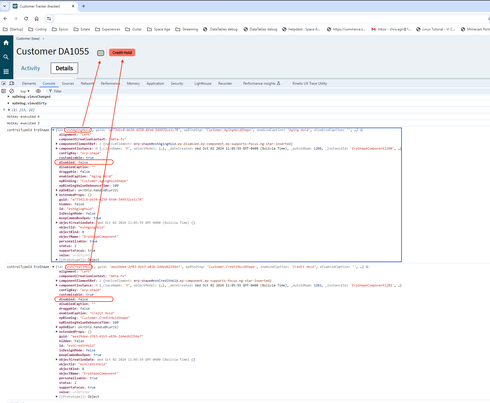

Rules Dump

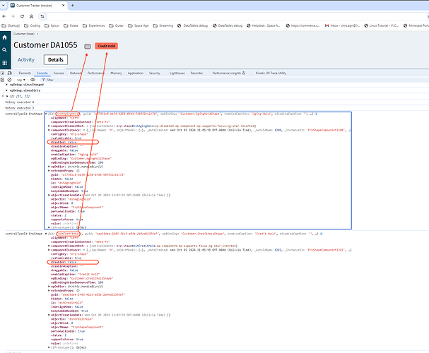

As a test, I repurposed the Global shape for Aging Hold and kept the system Credit Hold shape/rule. As you can see below, both shapes are showing disabled = false. So why is one disabled in the UI?

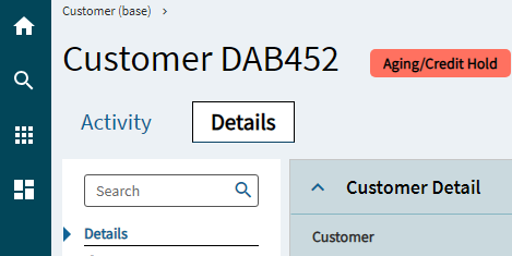

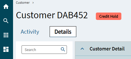

My workaround that really is not what I want is to put the shape down lower on the page - unfortunately, that is only on the Details tab:
…and it sometimes shows as gray, instead of red :man_shrugging: :dumpster_fire:

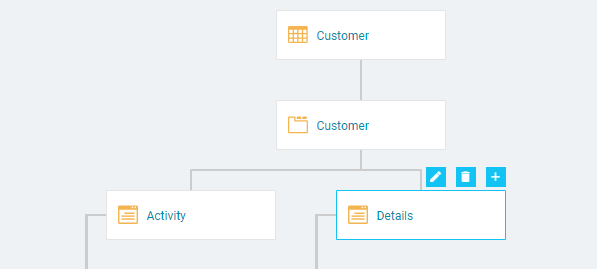

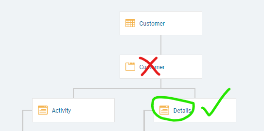

Remember if you’re adding it “down lower on the page”… you don’t want to edit the “Customer” page.
You want to add it on the “Details” page.
Yeah, I had to delete it from the tab page and re-create it on the Details page
At least you got something working … but this is just sad
Yup, I added it to the wrong page! Thank you.
