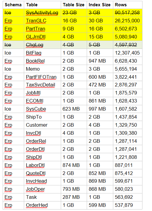

Here’s a snapshot from December. We’ve purged our SysActivityLog table already, and change log is purged monthly with a 2 year cut-off:

But right now our DB is slightly over 400GB. When you perform your purges do you actually see the DB size go down or shrink? I know shrinking the DB is not advised at all but I was wondering how the Epicor E10 Purge worked?
I need to look at our table sizes to see which Tables are the largest and which ones might be able to be purged.
