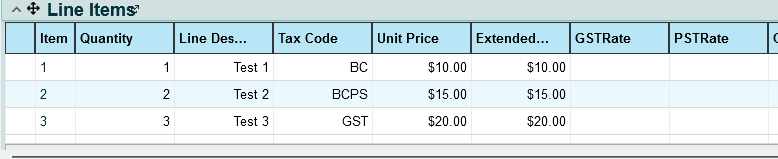

Here’s what I begin with:
I want the columns GSTRate and PSTRate to be populated with the appropriate tax rate.

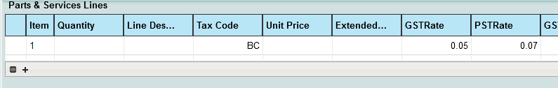

After running the workflow, this is what I get:
Only the top row is preserved, but the description, quantity, and price is gone! The second and third rows are just deleted.

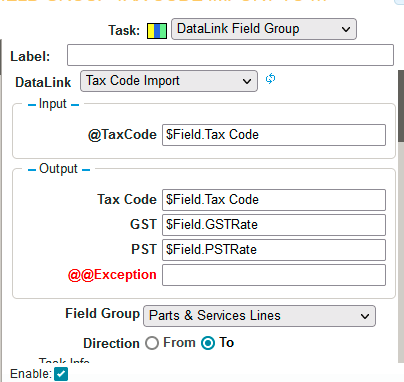

This is the workflow itself:

Try changing the “Direction” from “To” to “From” and test.

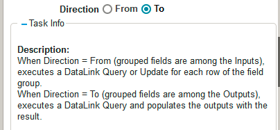

What in the seven hells, that actually worked. It’s behaving exactly the opposite of how the task description says it does
Glad it worked!
The way I always think of it is that the “To” option will wipe out the field group and replace it with the queried results, whereas the “From” option will update the field group with only the queried results as you direct it to. Field groups in general seem to have all sorts of nuances, subtleties, mysteries, etc.
OK I will keep that in mind. God, what a pain, lol.

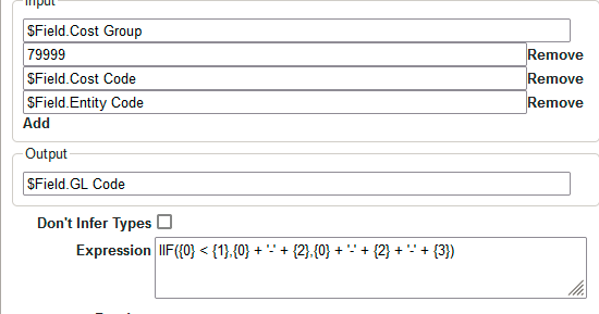

This is the task setup:

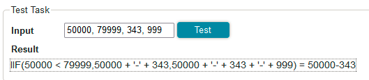

This is a test with a value less than 80000. The result is correct
This is a test with a value greater than 80000 (I used 79999 because I wasn’t sure if there was a “less than or equal to” symbol). Again, exactly how I want the result to work

I don’t get how it works in the test function but not when actually trying to run it.
Never mind! I fixed it - I needed ’ ’ marks around each of the {0} etc
