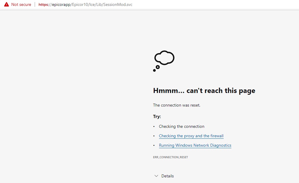

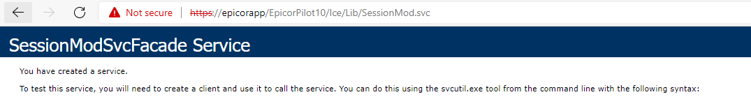

Anyways, I managed to identify why only Pilot was working when setting the datalink source. It turns out that the following URL is enabled for pilot, but not for the other environments. This is where I’m stuck, not sure how to expose this so that I can connect to production.

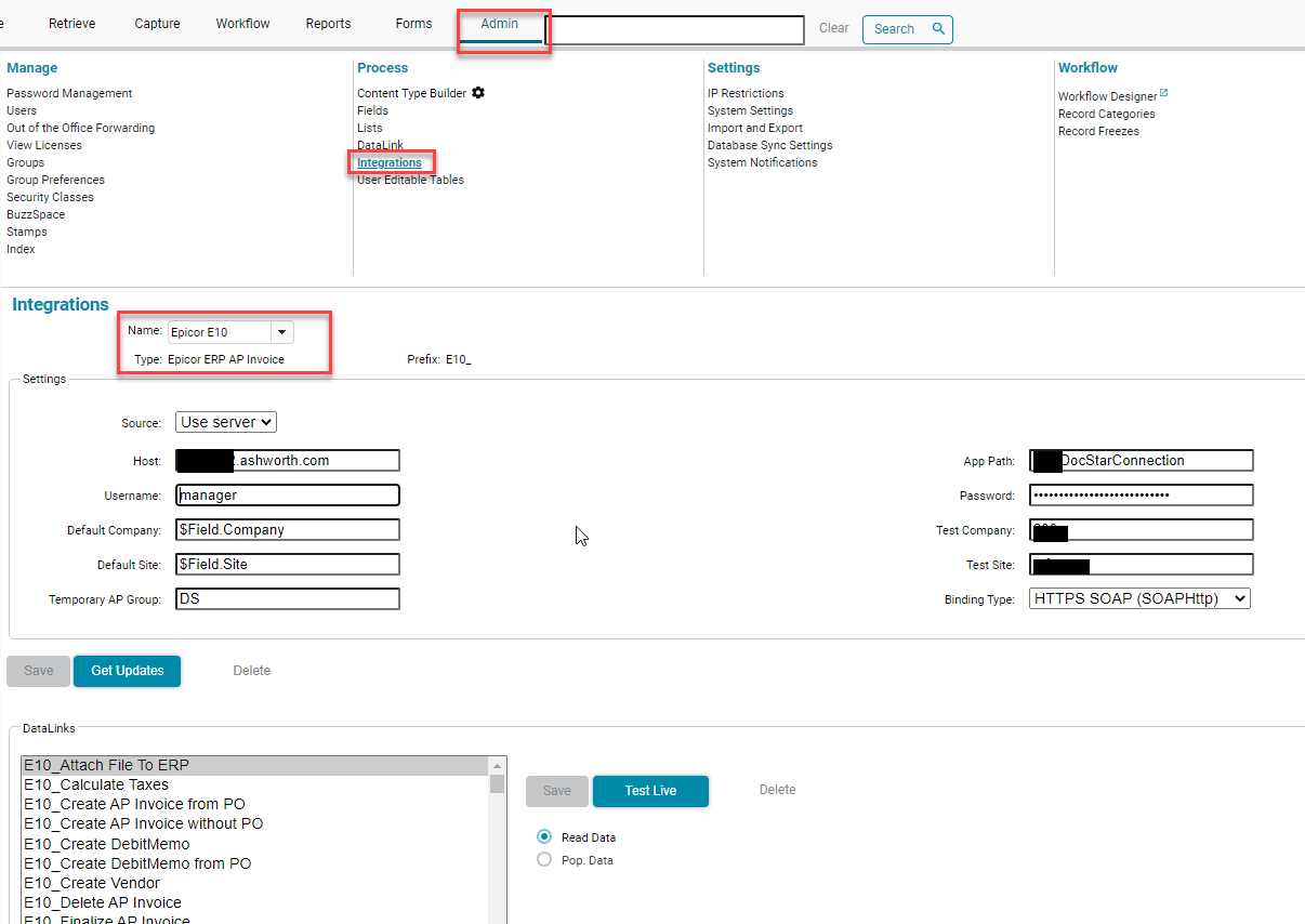

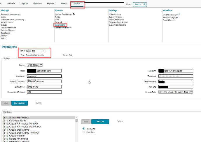

The integration piece that Epicor delivers is controlled by you as well, for the datalinks they delivered, using the screen below. Unless there is something else going on in your environment, this should be where you can change the Appserver connection (the change from Pilot to Prod for example)

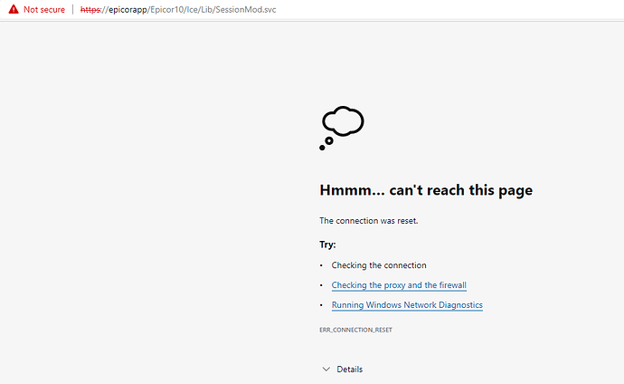

When I change the “App Path” on my V1 integration (exactly as shown above) to anything other than our pilot instance, it fails saying there is no connection. I identified the cause to be that URL I mentioned previously not being accessible. I can physically navigate to it on pilot and not on prod.
