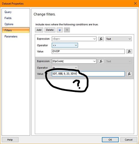

Good afternoon,
I am customizing the Job Traveler Report with a new style. In the Report Builder, I can see that there is a filter for the Dataset, and I can choose “IN” as an operator in that filter. I would like to use this to filter out a list of OpCodes from my report. I have dozens of opcodes to filter out. I was thinking I could use the “IN” operator, along with a list of OpCodes. How does that work in SSRS?
As advised by Chat GPT, I have to use the split function:
that value expression that I circled should be:
=split("5DT,8BB,9,20,3DW",",")
