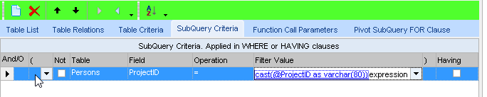

To be fair, I didn’t make a multi table query like yours. I just added a single table containing a field of varchar
Here’s the error:
System.Data.SqlClient.SqlException (0x80131904): Must declare the scalar variable "@Project".

And “Project” shows in the Expression editor?
Try re-creating the expression. Delete the current expression (in the Expression editor), then recreate it, but don’t type in @Project, double click it in the Available parameters area.
(yes, I made mine named different from yours … ignore that)
No, it doesn’t.

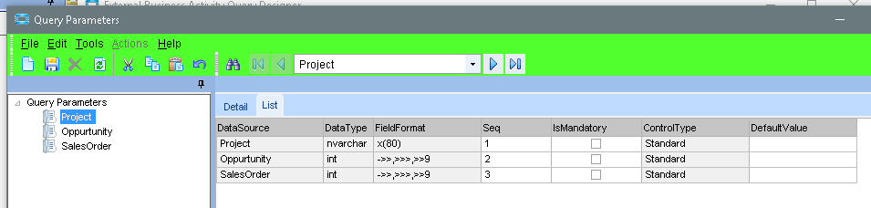

Should all 3 parameters in this list show in that expression screen?
I would think so.

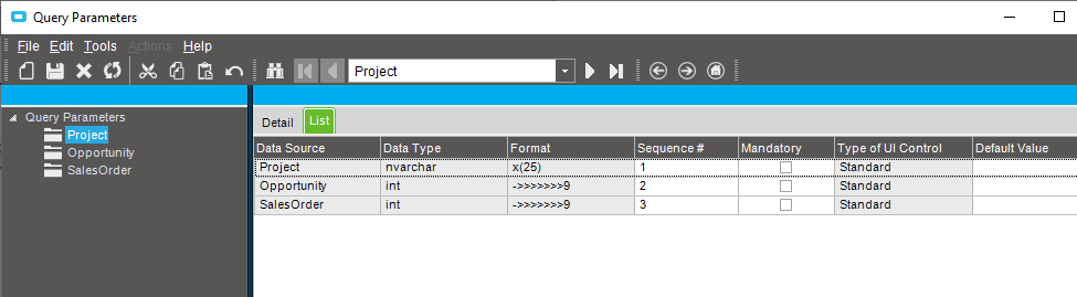

If I add another param or two, I see …
and in the editor …
I’m on version 10.1.400.23 too.

I started a new BAQ.
When I have one Parameter, it will show in the SQL Expression Editor.
When I add my 2nd and 3rd, the SQL Expression Editor shows none!
When I delete the 2nd & 3rd, SQL Expression Editor continues to show none.
I have an active case with support on this.

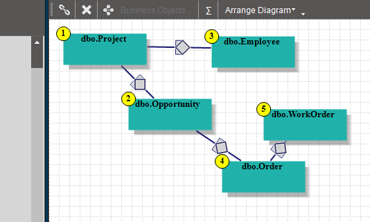

I made a extBAQ as close to yours as I could
and I can see them in the expression editor
One more thing … Why do you have FULL OUTER Joins between the tables?
In my recreation, I didn’t do that.
Unchecking the “Skip condition if empty” on the Parameter allows the field to show in the SQL Expression Editor.
Interesting side note: I had to set the parameter Default Value to 0 on the Integer type to finally get this working perfectly.
