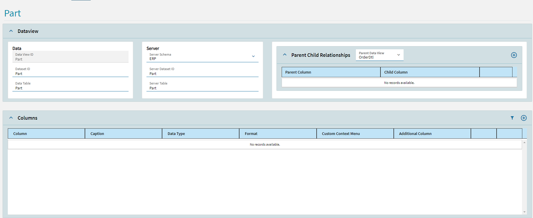

I have created a dataview which uses the Part table, but after I have entered ‘Part’ for the ‘data’ and ‘server’ settings no columns are retrieved from the table.

Hi
Below is the screen shot of my data view, thanks.

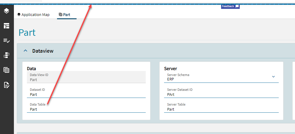

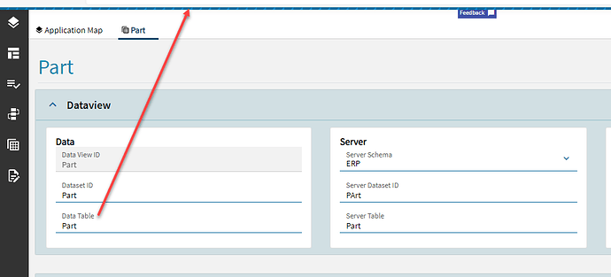

After you type in “Part” under the Data.DataTable, do you see the loading bar attempting to retrieve information?
I don’t, I just tried deleting and re-type and nothing appears.

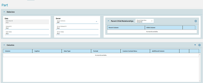

I just tried again creating the view for the part table and it still doesn’t create the columns. Very strange!

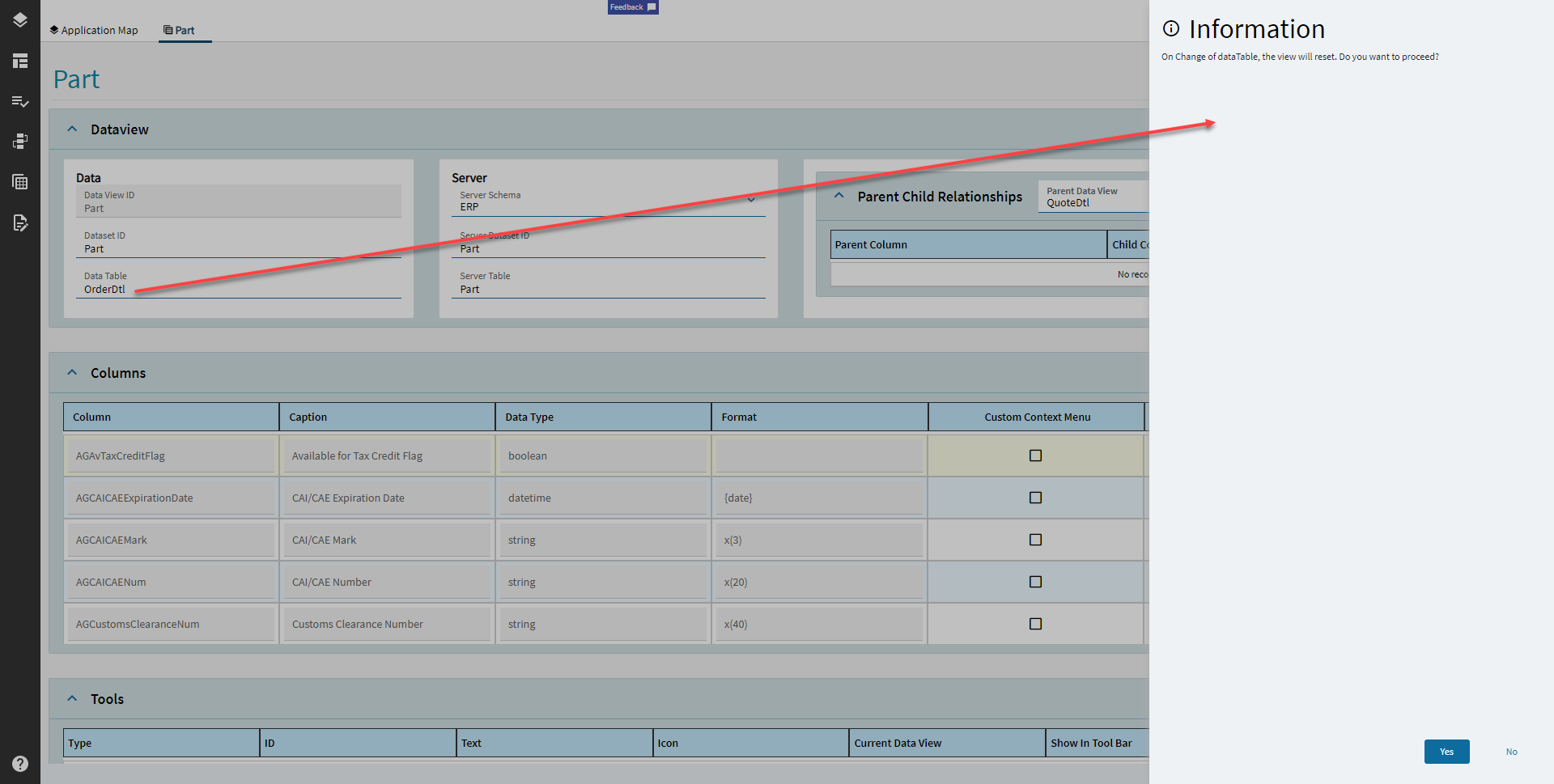

If you have it as OrderDtl and save, then switch to Part, do you get this Info Message?
