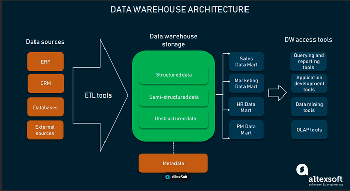

Do you do anything else related to data warehousing as seen in the flow below? Or is it strictly access to BAQs and the users have to build the queries every time? This could lead to a much longer thread than necessary…
A data warehouse is basically a place where you do long term storage of historical data typically rolled up via something called OLAP Cubes, these cubes (or new tables) is where basically you roll up and store say total sales or total cost (different measures) grouped by date, city, territory, sales rep etc
So on top of OrderHed, OrderDtl etc you’ll have OrderTotalsByRep where the values are pre-calculated and stored.
It is an easier way to do data analytics because the rollups are PreComputed instead of having to do those sums up front.
Power BI, Grow etc will usually do this so that they can return data faster, the “downside” is that those computations take time and are time delayed so the Data Warehouse usually re-computes its values a few times a day but it isn’t real time.
We also use this for our Power BI Reporting where we have reports driven from rolled up sales figures so we can provide quick KPIs
Epicor also has this facility built in via what they called executive queries. These BAQs generate “Cubes” that can be scheduled via System Agent to RollUp stuff and store it, then you can write dashboards etc off those cubes
