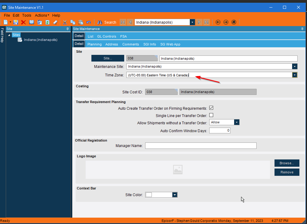

Do you have a timezone assigned in site or company maintenance? I think I ran into this before but I can’t remember the exact details.
We just updated, and they added a time zone… somehere… plant settings I think? And they didn’t populate it, we had to populate it, and it fixed some stuff like that.
I think it was this one?

I only see it in site maintenance and it is set correctly.
When I ran into this before the problem was it was a date-time field and the timezone difference between the different sites caused it to shift to the wrong day, and unsetting the timezone fixed it. Probably not the right solution but it worked at the time.
I tried this turning off the time zone in site maint, saving, then testing a few iteration, and then resetting the time zone. This did not change the functionality. I also have been trying to use the Infragistics.Win.TimeZoneInfo to modify the datetime before I save it. I have tried lines like this (based on suggestions from AI):
