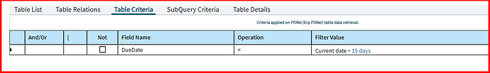

I have added a criteria on a BAQ that looks at open PO’s due in the next 14 days. This is returing dates further than this horizon. I am using the following
this is on the dueDate on PORel

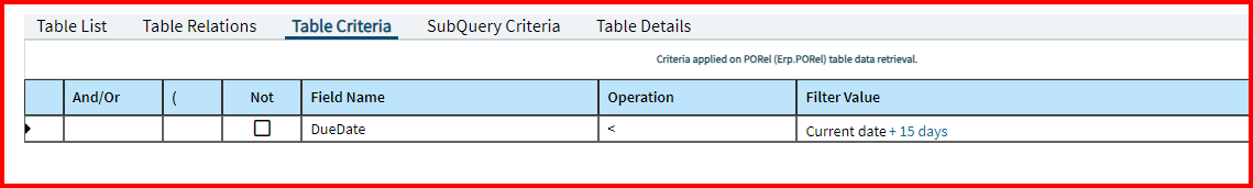

That looks like it should work. You’re gonna have to show a lot more info for us to help you figure out what’s wrong with your query.
The query is

I don’t see a where clause in that query. Are you sure you added the filter?
edit: Or the table PORel…
