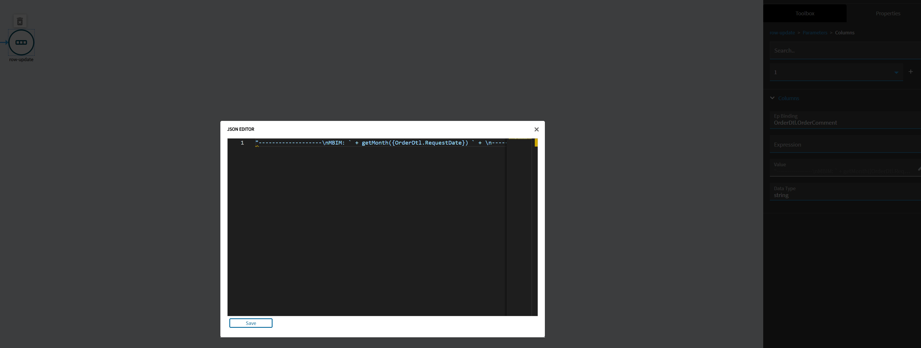

Trying to standardize a comment text under specific scenarios and I’m hoping to dateformat the value that gets copied into the text field. Is there a way to do this in the JSON editor on row-update?
I would do it in a function. Pass the date value in, return a string formatted however you want, then just add {actionResult.FunctionReturnString} in your row-update.

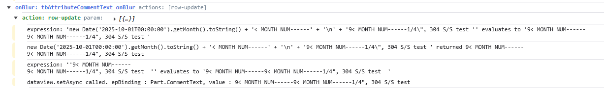

Edit: The following does work in expression property (rather than json value) of row-update event to concatinate the month into the comment field if that’s what your trying to do.
'#_ new Date('{Part.OnHoldDate}').getMonth().toString() + '< MONTH NUM------' + '\n' + '{Part.CommentText}' _# '
Just don’t forget to put a “+1” after getMonth()
January is month 0.
