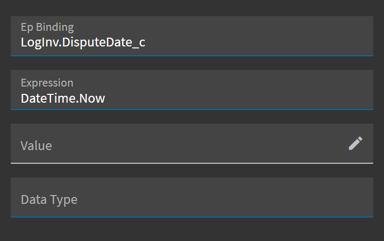

Anyone know how to set a value or compare a value to a DateTime.Now in application studio?
I would like to set this variable to the DateTime.Now value, but off course this way it doesn’t work.

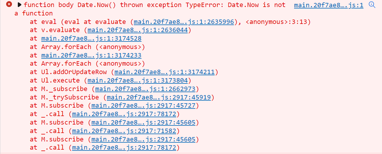

Try Date.Now() Scratch that.

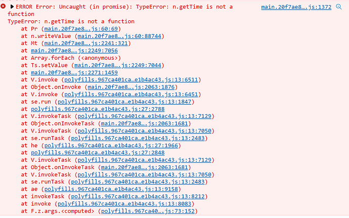

Thanks for the quick reply. Tried that as well, but I get the following message:
Ah yeah, that definitely brings me closer. It now does something with a getTime :smiley:
Still one thing to fix

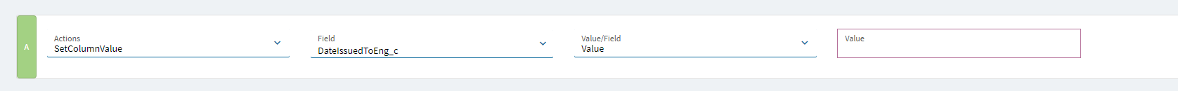

Instead of JS, set the value to this instead: “{Constant.Today}”
You’re right. That’s way more easy! Thanks alot!
