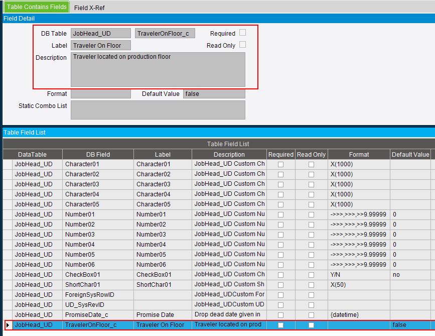

It’s designed to show your UD tables.

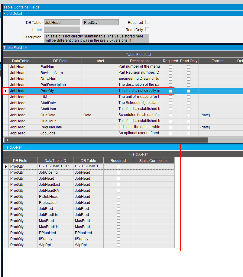

Their fields ext props as well
Want to know where the same field can be found elsewhere consult the x-ref

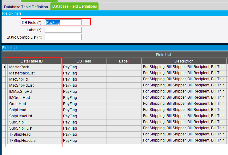

You may also perform a field lookup specifically if you like. Want to know where a field all shows up search

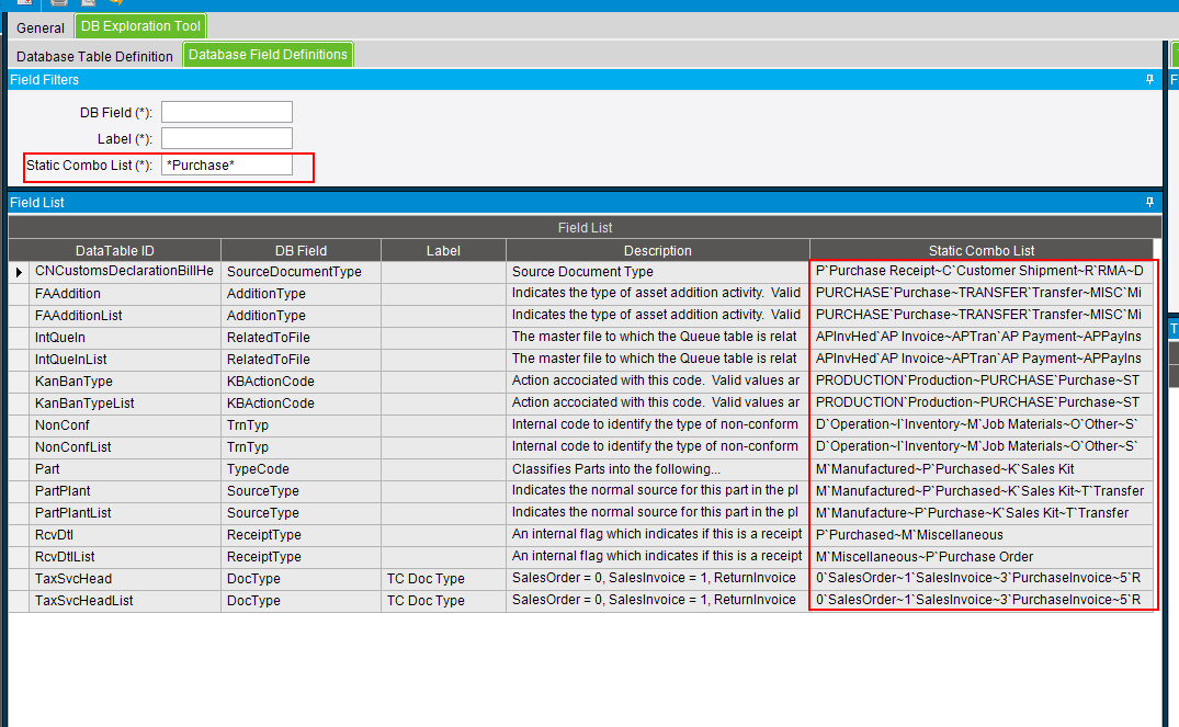

Want to know where those pesky dropdown values come from, what the value codes are, and where they all are in the system? search
