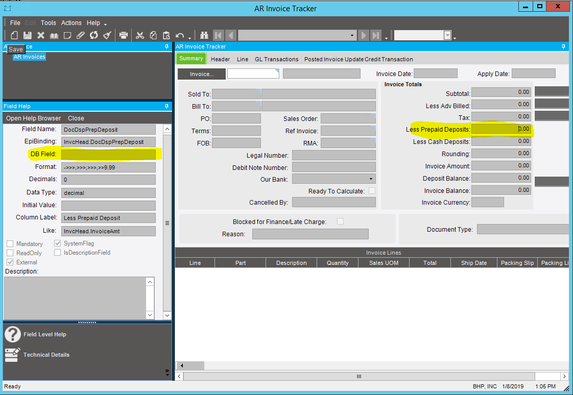

Is there any way to find out more info about a field in a form. A lot of time you can get the DB field from the field help, but sometimes the form is doing a little magic and it isn’t as easy as a one for one from the form field (dataview?) to the DB field.
Is there some way to figure out when this logic is? For example, on the invoice tracker below the less prepaid deposits field has an EpiBinding but no DB field. Looking at the InvcHead table itself, I don’t see a DocDspPrepDeposit field. Is there a way to see the logic behind creating that EpiBinding or some documentation out there.
@josecgomez I know this post is old but have you found any more information on this? I need this value for some logic I’m creating. The ARPrepaymentTran table is only for Deposit Invoices, however I need the value from Shipment invoices. Here is the field from a Shipment Invoice.
